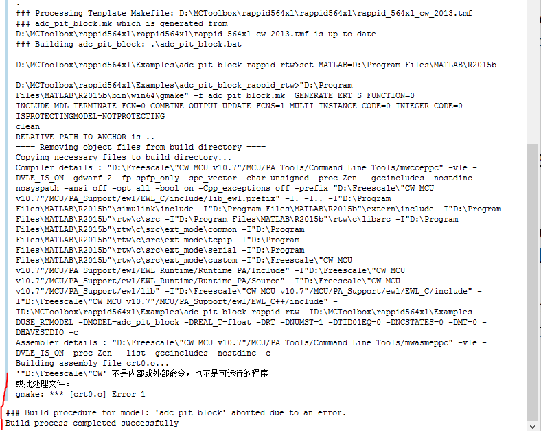

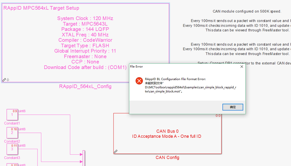

Hello everyone,
   When I built the can_simple_block_rappid_rtw_demo,it could not generate .mot file,and an error accoured ,which hinted that  the RAppID Boot Loader failed to find can_simple_block_rappid_rtw.mot .捕获.PNG

It is caused by the wrong placement of the " " in the path of the system variable. Remove those " " and just copy paste the location from a Window explorer.

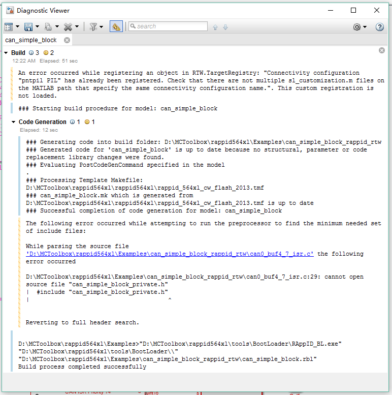

This is a bit strange. I can't reproduce the problem on my side. Can you give me a few details about your setup:
- matlab version
- toolbox version
- a copy of the Matlab Diagnostic Viewer
Looking forward to hearing from you soon.
Thank you!
6,392件の閲覧回数
hjhjhj
    The matlab version used by me is matlab2015b and  the  Toolbox version  for MPC5643L  is 1.3. By the way,my computer system is WIN10.
      The  Diagnostic Viewer
   Thanks for your help!

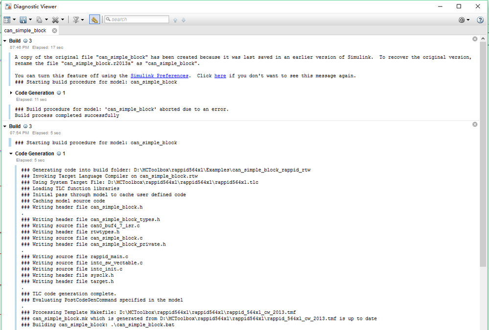

Daniel_Popa
Hi hj,
I re-tested the toolbox using your setup: Win10+Matlab 2015b on 64b and fresh install of 1.3 version and it works. See the attachment. Can you compare the folder content with the one generated on your computer? Does it contains the same files?

hjhjhj
 Hi Daniel,
      I did it  with gour method :install  the toolbox  again with administrative rights  on my PC.However,.mot  file still does not exsit ,and another error generates .Can you help  me check it ?

'"C:/"Program' is not recognized as an internal or external command,
operable program or batch file.
gmake: *** [crt0.o] Error 1
If so, then you have not set correctly the system variable for MW_TOOL.

Daniel_Popa
