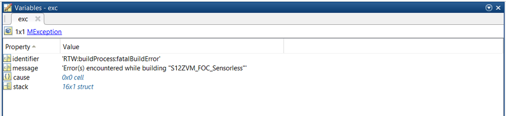

ozenyavas
Hello Daniel,
Thank you very much for your reply. I have checked the link that you provided me, however, when I load the build_exception.mat file, I do not see root causes for the error, please see the picture below. And even though the _rtw file is populated, it gives a build error, and unfortunately I could not understand the reason behind.
Would you have any other recommendations for my situation?
Kind regards,
Ozen
3,089件の閲覧回数
Daniel_Popa
Hi ozenyavas‌,
Please refer to this fix: https://community.nxp.com/thread/451909#comment-1008959
Hope this will help you!
Thank you!
3,089件の閲覧回数
ozenyavas
Many thanks Daniel, it helped!
