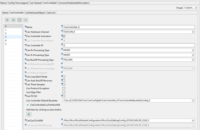

In the configuration for can controller, can 0 to can 5 are assigned controller ID from 0 to 5 respectively.

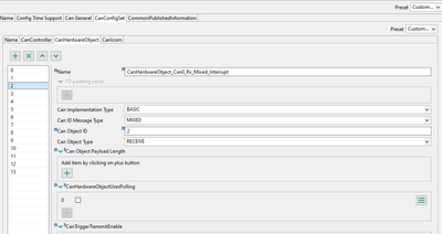

In the CanHardwareObject, I have set can 2, 3, 4, 5, 6, 7 to be receive interrupt for CAN 0 to CAN 5 respectively.

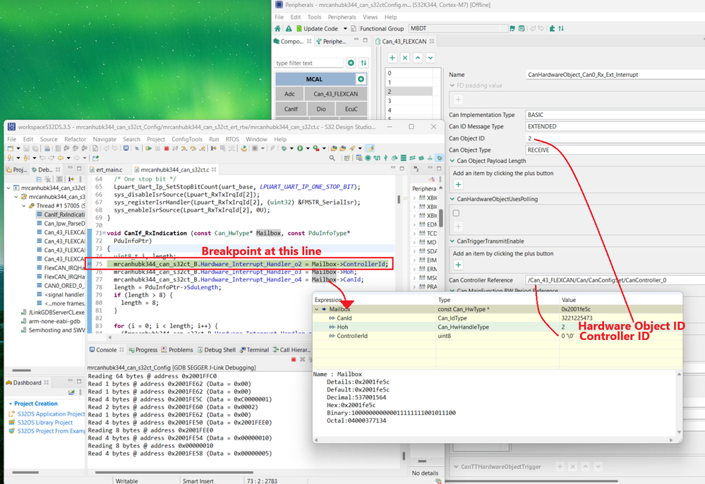

In order to test the consistency of the CanHardwareObjectID and the CanControllerID I recommend using the S32 Design Studio debug capabilities.
Please import the generated project from Matlab into S32DS and, after building again the project, start the debugging session using the elf file generated with this second build.
Place a brakepoint at the beginning of function CanIf_RxIndication.
Whenever a message is received, the input parameter called "Mailbox", will provide the needed information about the CAN message:
data, id, ControllerID, HardwareObjectID, etc.

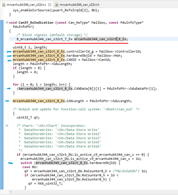

The two files that we update is the mrcanhubk344_can_s32ct.c and mrcanhubk344_can_s32ct.h.
First, in the header file, we comment out lines indicate by the blue line, and added a new typedef struct indicate by the red bracket.
Then, in the main file, we added the a line underline in red, and update everywhere else to the new typedef in blue.
My explanation may be not be very clear, let me know if you can understand the update and its purpose.

In the original generated code, the buffer used for storing the CAN message information pointed to by the mailbox pointer, is instantiated in the RAM memory (BSS or data) - B_mrcanhubk344_can_s32ct_T mrcanhubk344_can_s32ct_B;  - declaration placed at the beginning of the mrcanhubk344_can_s32ct.c file.
The modification to the generated code you introduced, places the buffer on the Stack memory - B_mrcanhubk344_can_s32ct_T_Ex mrcanhubk344_can_s32ct_B_Ex declaration is now placed inside the callback function CanIf_RxIndication in that same .c file.
It's not clear what exactly is the impact of moving the buffer from global memory to Stack, but I'm happy it fixes the problem.

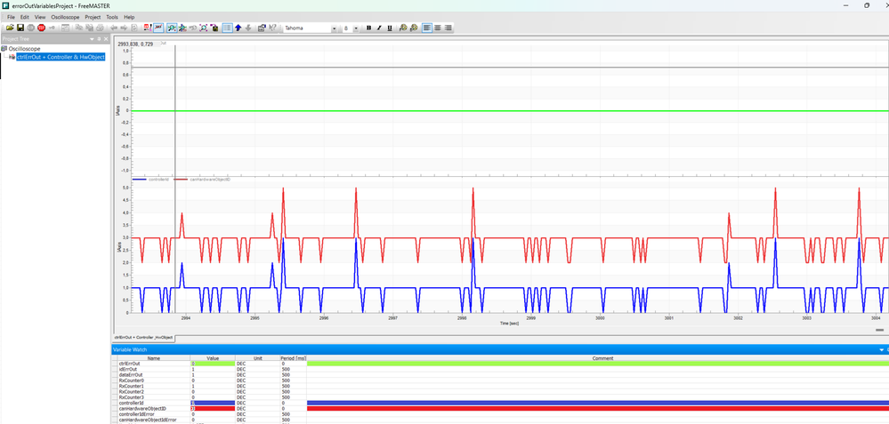

As you can see in the attached pictures multiple CAN messages are sent at intervals of less than 1 ms for a long period of time and still, CanHardwareObjectID allways corresponds to the ControllerID.
All 4 CanControllers receive messages but ctrlErrOut is always zero (represented with light green). In the above picture, the canHardwareObjectId (represented with red) is always 2 units greater than ControllerId (represented with blue) which means that the CanHardwareObject always corresponds to the correct CanController.
I also tried with different optimization levels but got the same results.
