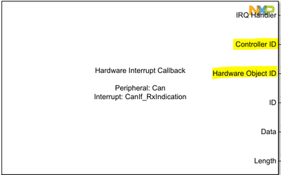

Hi, I have noticed a issue when using S32k344, that is, controller ID and Hardware Object ID does not match for the corresponding CAN message origin.
In the configuration for can controller, can 0 to can 5 are assigned controller ID from 0 to 5 respectively.
In the CanHardwareObject, I have set can 2, 3, 4, 5, 6, 7 to be receive interrupt for CAN 0 to CAN 5 respectively.
Therefore, with the above set up, I'm expecting the receive block will get this:
ControllerID
0
1
2
3
4
5
CanHardwareObjectID
2
3
4
5
6
7
Normally, this work as expected.
However, there are accumulative cases where controllerID and canHardwareObjectID that does not match the origin of the CAN message.
For example, I have received can controllerID 3 with CanHardwareObjectID , controllerID 3 with CanHardwareObjectID 2, controllerID 2 with CanHardwareObjectID 3, controllerID 2 with CanHardwareObjectID 2.
This has serious implication since this mean that the CAN message are no longer reliable due to data being incorrect. Is there something I have configure correctly? I have attached the project that encounter this issue. Thanks!

CanHardwareObjectID and its associated CanControllerID are both provided in Simulink by the Interrupt block CanIf_RxIndication, which you already highlighted in this thread.
In order to be completely sure that there is an inconsistency between the CanHardwareObjectID and its associated CanControllerID,
one must also make sure that the methods used for analysing this issue are capable of capturing this event and deliver all the related data before the next CAN message receive event occurs.
As I can see in the model from the first attachment you provided, all the information regarding the CAN messages, is further transmitted via the UART interface for analysis.
This method of analysing the CAN signals is highly dependent on the rate at which the CAN messages are received and the speed of the UART communication.
If not enough time is allowed for the UART_SyncSend block to finish the transmition of all the bytes in the message, then the next UART_SyncSend call will overwrite the output buffer, hence corrupting the data.
The fact this incosistency is intermitent ("there are accumulative cases where controllerID and canHardwareObjectID that does not match the origin of the CAN message") most likely indicates an issue with the UART communication.
In the model from the second attachment I assume that you are using FreeMASTER and volatile variables for monitoring the information about the CAN messages.
Not sure how one can keep track of which CanHardwareObjectID is associated to which CanControllerID in this manner. Please also take into consideration the refresh rate of the variables in the FreeMASTER PC application.
In order to test the consistency of the CanHardwareObjectID and the CanControllerID I recommend using the S32 Design Studio debug capabilities.
Please import the generated project from Matlab into S32DS and, after building again the project, start the debugging session using the elf file generated with this second build.
Place a brakepoint at the beginning of function CanIf_RxIndication.
Whenever a message is received, the input parameter called "Mailbox", will provide the needed information about the CAN message:
data, id, ControllerID, HardwareObjectID, etc.
