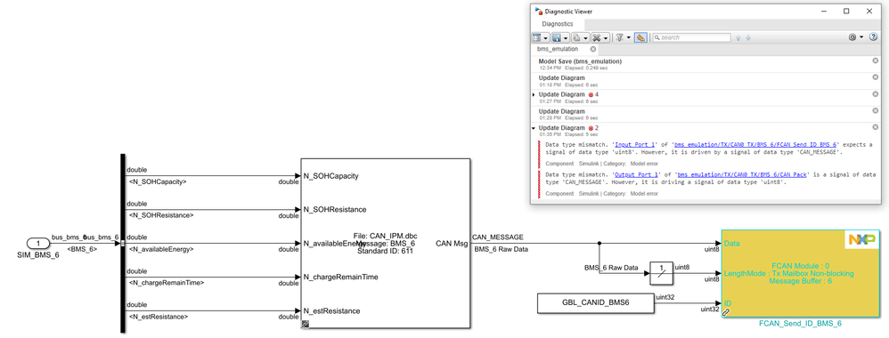

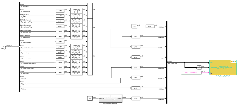

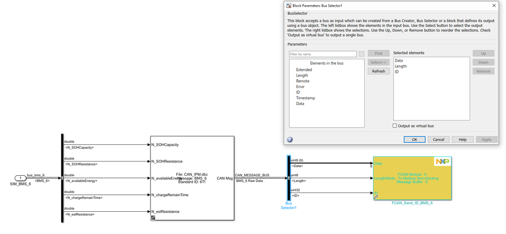

At the moment I am having to manually pack CAN messages using bit shifts, masks, mux etc in order to construct 8 bytes of data to transmit a CAN message.  An example of one such message is shown below...
However, this is very tedious especially when there are lots of CAN messages to pack.

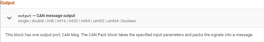

I came across the embedded coder block 'CAN pack' which imports the CAN database, but unfortunately I cannot get this to work.
There is a data type mismatch because the 'CAN Pack' output is not a structure...
The 'CAN pack' block does not seem to output structures...
Should this 'CAN pack' block work with the 'FCAN_Send' block and if so, how ?
If not, is there another way of packing the CAN messages (preferably by importing a CAN database) ?

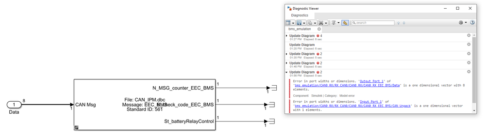

CAN unpacking
I haven't tried unpacking signals from the 'FCAN_Receive' block yet, so far I have only unpacked the 8 raw bytes of data as shown below...
For testing purposes I have made byte 1 control a digital output (LED).
How can I extract the signals from the 8 bytes of raw data, without having to manually implement the unpacking using bit shifts, masks, mux etc
I tried the embedded coder block 'CAN unpack' which imports the CAN database, but unfortunately I cannot get this to work.
There is a data type mismatch because the 'CAN unpack' input does not allow structures...
Should this 'CAN unpack' block work with the 'FCAN_Receive' block and if so, how ?
If not, is there another way of unpacking the CAN messages (preferably by importing a CAN database) ?

UPDATE:

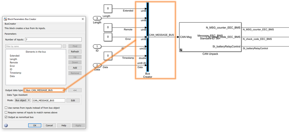

I have managed to get 'CAN Unpack' to work as follows:
1. Create the datatype 'CAN_MESSAGE_BUS' by running the command 'canMessageBusType' at the MATLAB prompt.  To see the structure of the datatype, run 'CAN_MESSAGE_BUS.Elements'...
2. Create a bus and set the output data type to 'CAN_MESSAGE_BUS'.  The inputs to the bus are as follows:
  • Extended
    • datatype uint8
  • Length
    • datatype uint8
  • Remote
    • datatype uint8
  • Error
    • datatype uint8
  • ID
    • datatype uint32
  • Timestamp
    • datatype double
  • Data
    • datatype uint8(8)

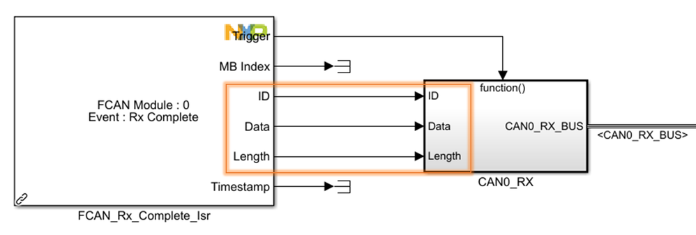

3. The following outputs from the NXP Rx Complete block are used as the inputs to the 'CAN Unpack' block...
  • ID
  • Data
  • Length

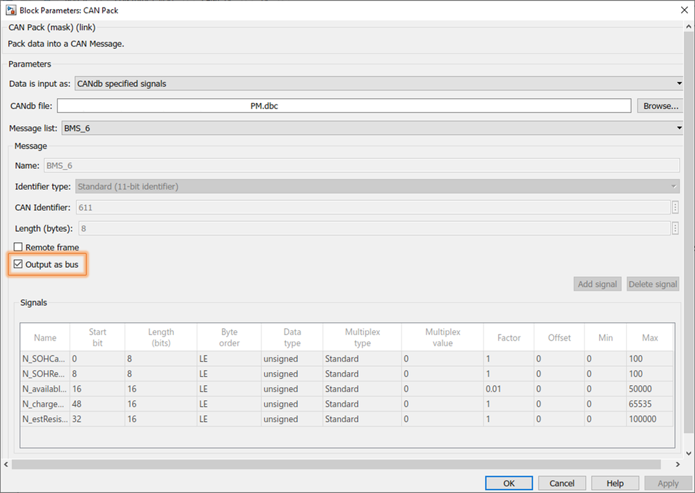

johngreenjets
UPDATE:
I have managed to get 'CAN Pack' to work, but I'm not having any luck with 'CAN Unpack'.
To get 'CAN Pack' to work, I set the output as a bus...
The bus elements are shown below...
In this case I selected the bus elements Data, Length and ID to use with the FCAN_Send block.
I tried creating the same bus for 'CAN Unpack', but this did not work...
