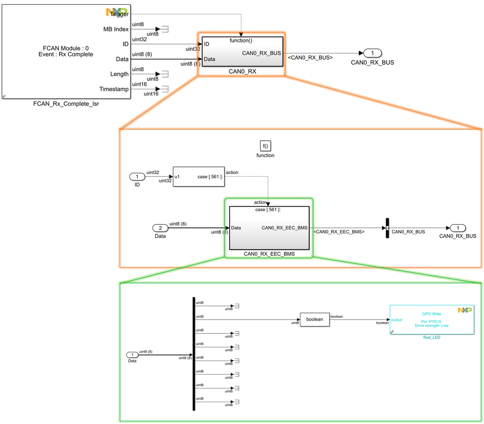

CAN unpacking
I haven't tried unpacking signals from the 'FCAN_Receive' block yet, so far I have only unpacked the 8 raw bytes of data as shown below...
For testing purposes I have made byte 1 control a digital output (LED).
How can I extract the signals from the 8 bytes of raw data, without having to manually implement the unpacking using bit shifts, masks, mux etc
I tried the embedded coder block 'CAN unpack' which imports the CAN database, but unfortunately I cannot get this to work.
There is a data type mismatch because the 'CAN unpack' input does not allow structures...
Should this 'CAN unpack' block work with the 'FCAN_Receive' block and if so, how ?
If not, is there another way of unpacking the CAN messages (preferably by importing a CAN database) ?

UPDATE:
I have managed to get 'CAN Unpack' to work as follows:
1. Create the datatype 'CAN_MESSAGE_BUS' by running the command 'canMessageBusType' at the MATLAB prompt.  To see the structure of the datatype, run 'CAN_MESSAGE_BUS.Elements'...
2. Create a bus and set the output data type to 'CAN_MESSAGE_BUS'.  The inputs to the bus are as follows:
  • Extended
    • datatype uint8
  • Length
    • datatype uint8
  • Remote
    • datatype uint8
  • Error
    • datatype uint8
  • ID
    • datatype uint32
  • Timestamp
    • datatype double
  • Data
    • datatype uint8(8)
3. The following outputs from the NXP Rx Complete block are used as the inputs to the 'CAN Unpack' block...
  • ID
  • Data
  • Length
