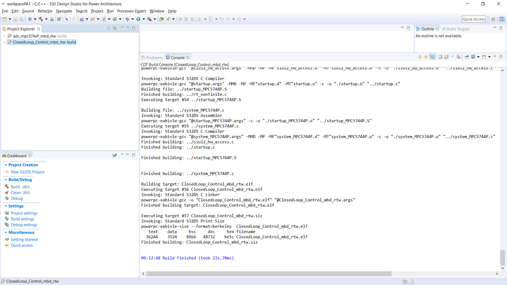

haoxue1027
Contributor V
Hello.
I try to rename all .S to .s
it already works like following:
thank you very much.
best regards
hao

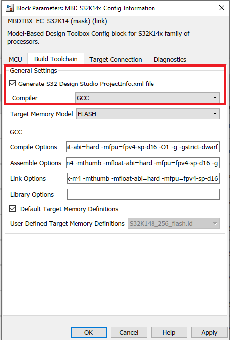

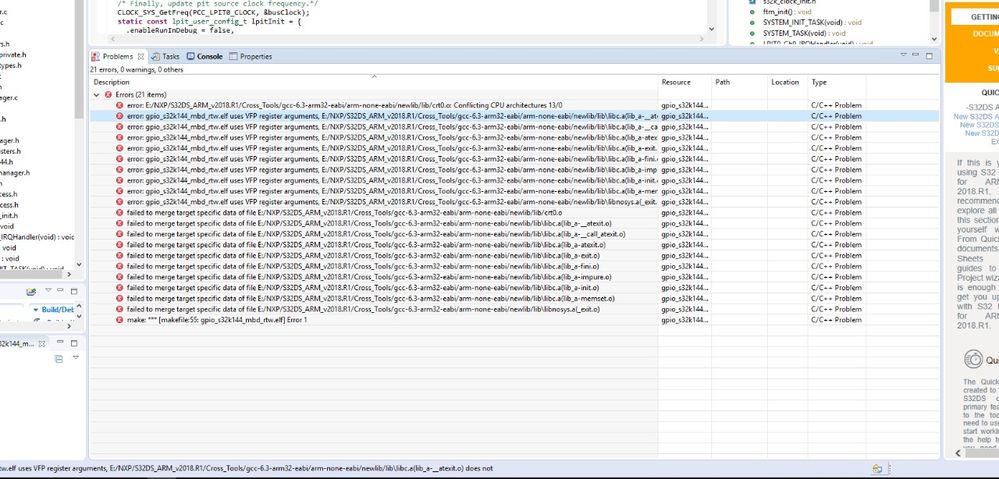

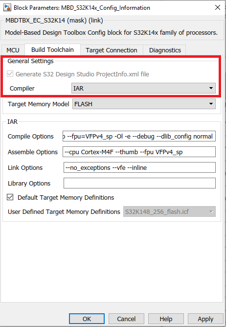

daovietanh
Hi Daniel,
I want to export generated code from matlab with S32K14x to S32 Desig Studio IDE or other like IAR...,
How can I do that?
Thanks you!
17,896 Views
Daniel_Popa
Hi daovietanh‌,
For the S32K14x - we have the same procedure for exporting the project to S32 Design Studion as the one described in the beginning of this article.
  1. you select the "generate S32 Design Project ...
  2. you import the project in S32 DS using "Project XML" option
Hope this helps!
17,893 Views
daovietanh
Hi Daniel,
In the Configuration parameter of S32K, there is no option to choice "generate S32 Design Project" as you decribe. But in the 'Block Parameters : MDB_S32K14x_Config_Infomation' / 'Buid Toolchain' allows users to create file.xml but only with GCC Compiler.
I did this, but when i import project XML from S32DS, it buid errors. May be I configured it incorrectly. Can you describe more detail with S32K14x?
17,784 Views

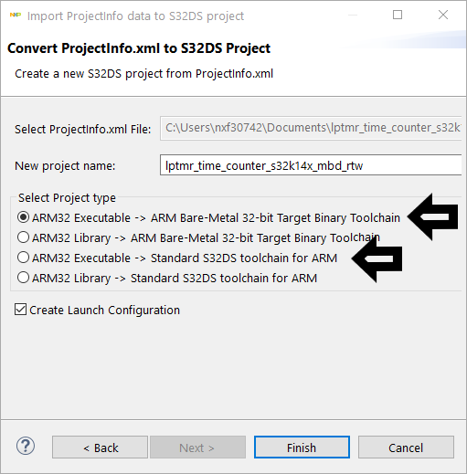

constantinrazva
Hello daovietanh‌,
Sorry for the delayed answer - your problem is due to the fact that you have used other version of gcc between MATLAB and S32Design Studio (when you imported the project). When you select to import using ProjectInfo.xml, you have a selection to make:
Depending on what version of gcc you have used (4.9.x vs 6.3.x), you have to select the first one, or the 3rd one (both ARM32 Executable, the difference being the toolchain - ARM bare-metal vs standard S32DS). So please try to import it again, selecting the other one of the 2 shown in the picture above.
Please let us know if you're still having issues with this problem.
Kind regards,
Razvan.
17,739 Views
daovietanh
Hi Daniel,Razvan,
That great, I 've builded sucessful. It is due to different version of gcc between MATLAB and S32Design Studio and I chose the 3rd type (Standard S32DS toolchain for ARM). That is OK
Thanks you so much!

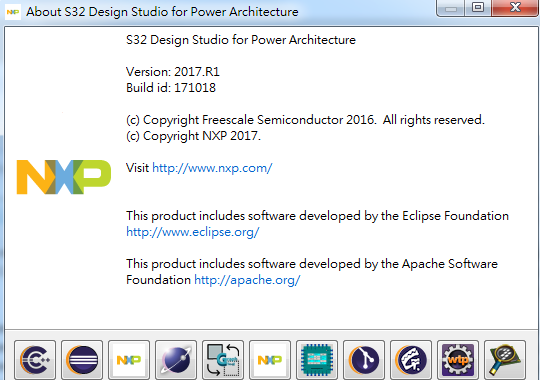

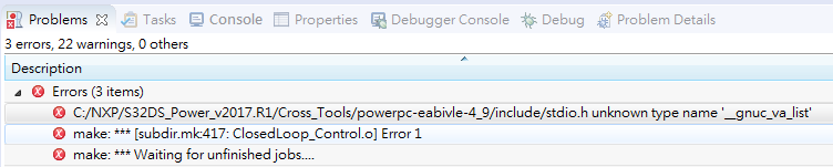

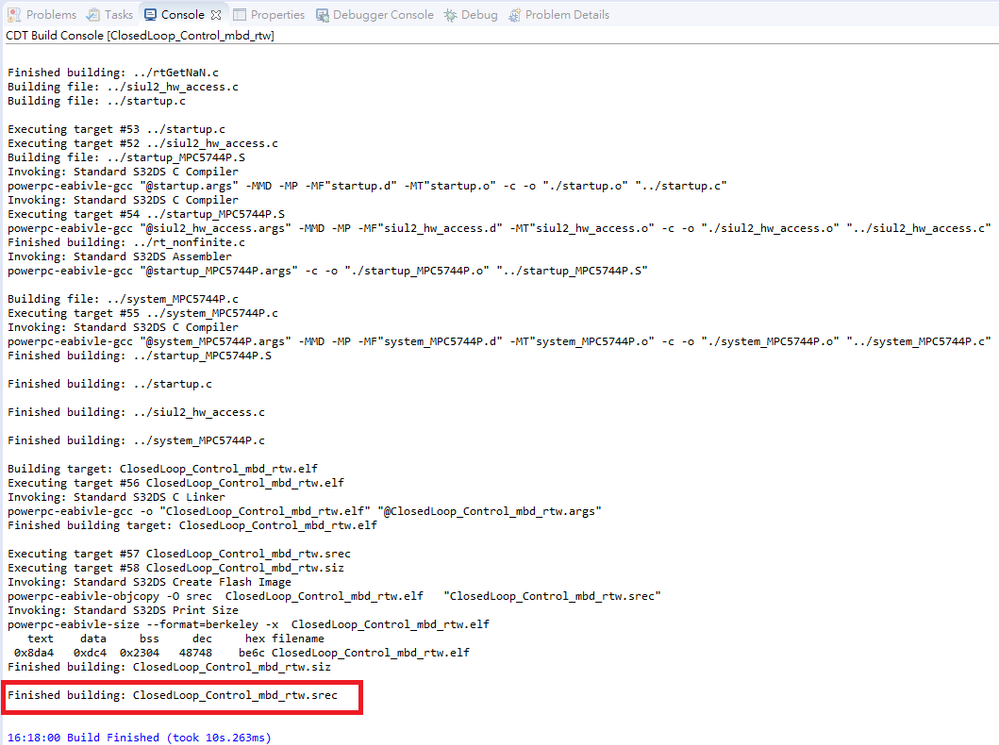

c9356j
Hi Daniel,
Could you help me?
error
C:/NXP/S32DS_Power_v2017.R1/Cross_Tools/powerpc-eabivle-4_9/include/stdio.h unknown type name '__gnuc_va_list'
2019-05-09_111444.png2019-05-09_113034.png2019-05-09_113049.png2019-05-09_113106.png2019-05-09_112333.png
16,269 Views

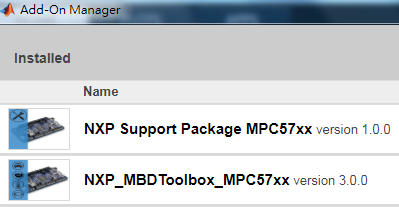

Daniel_Popa
Hi Jason Liu,
I see you are using the latest MBDT for MPC57xx 3.0 which is good. The toolbox can export the generated C code so that it can be later on imported into S32 Design Studio.
Can you please try to import & build the project attached here? I would like to exclude a S32DS configuration issue.
Thank you!

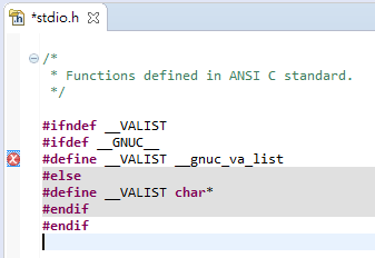

Daniel_Popa
Hi [email protected]‌,
Seems to be and issue with compatibility between the S32Design Studio and the built tools provided with MBDT.
To fix it, just remove the include path highlighted below. This path is not absolutely necessary since the S32DS has it's own compiler, hence it will avoid any compatibility issues.
Once you remove and rebuild the project it should work fine
Hope this helps!

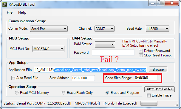

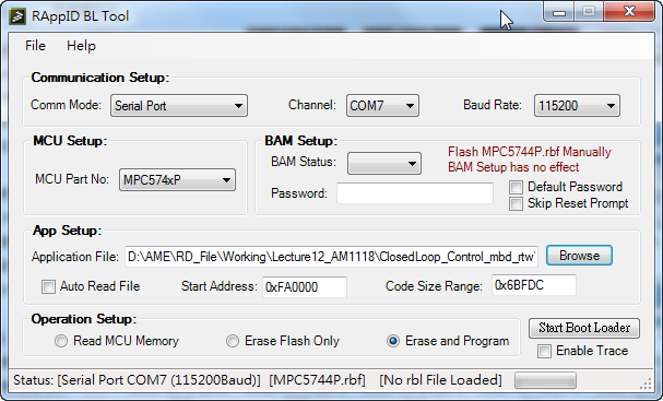

c9356j
Hi Mike, dumitru-daniel.popa‌
Thanks for your support.
Yes, that's right.
1) Generate code and build model from MATLAB, then use RAppID Bootloader to flash over JTAG is WORKING.
-- >  (a).rar
         " ClosedLoop_Control.mot" -- > This file is ok .
2) Generate code and S32DS Project file from MATLAB, then use S32DS to builld and then use RAppID Bootloader to flash over JTAG is NOT WORKING.
-- >  (b).rar
       "ClosedLoop_Control_mbd_rtw.srec "--- > is not working
14,815 Views
c9356j
Hi mikedoidge‌ and dumitru-daniel.popa‌
Can there be a solution?
We are in need of this way to build a motor control solution。
14,815 Views

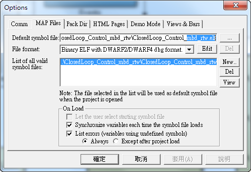

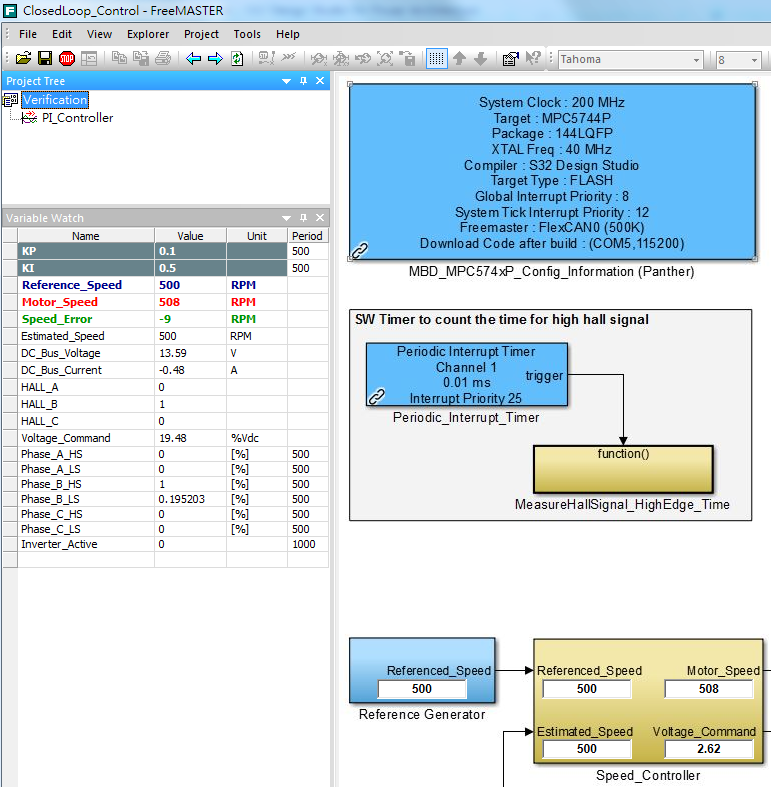

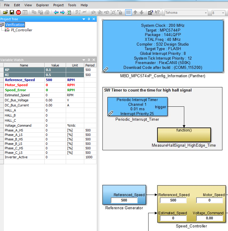

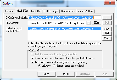

mikedoidge
Hello [email protected]‌,
Perhaps I missed it somewhere in the thread history here. Could you please identify again where exactly the issue occurs? Is it failing to run the code on the hardware after RAppID Boot Loader completes? OR Is it running the code but the code isn't operating correctly? It is important to know this difference as it points to two separate causes.
Looking at the images you provided, it appears that RAppID Boot Loader is correctly loading the SREC file. It also appears that the application is executing because FreeMASTER is able to connect but fails to exchange any data with the application. Is my understanding correct?
Mike
14,809 Views

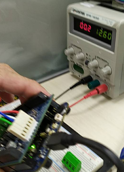

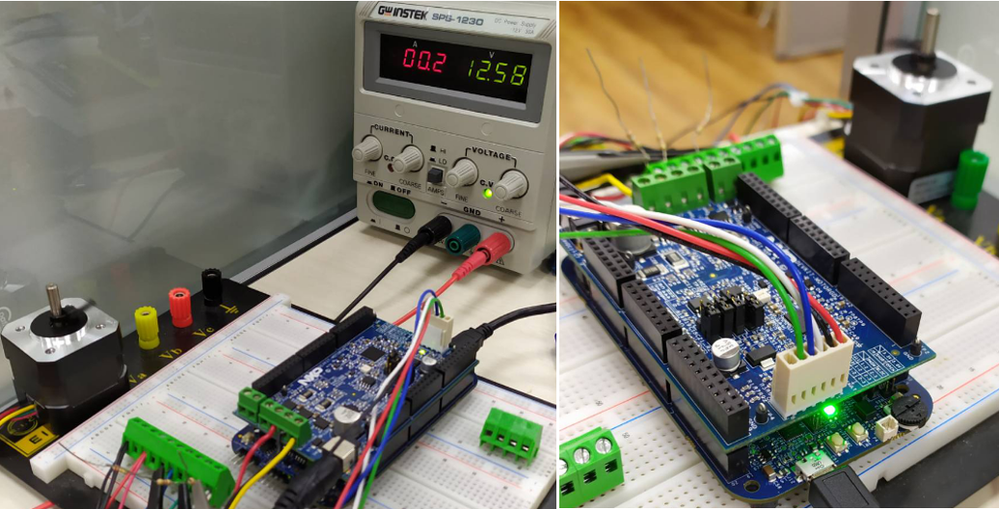

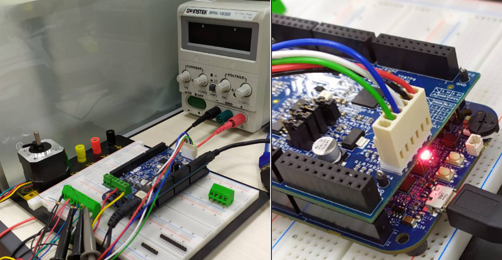

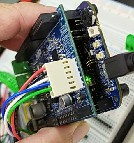

c9356j
Hi mikedoidge‌
-- >  (a).rar
Step1. Matlab - - > Simulink , Generate code and build “Lecture12_MPC5744P_v3.0.0”
Step2. RAppID BL Tools , Download Firmware “ClosedLoop_Control.mot”
Step3. DEVKIT – MPC5744P “LED Red ON” Motor Power OFF
Step4. DEVKIT – MPC5744P “LED Green ON” Motor Power ON
-- >  (b).rar
Step1. Matlab - - > S32DS Open “*.xml” File, Generate code and build
Step2. RAppID BL Tools , Download Firmware “ClosedLoop_Control_mbd_rtw.srec”
Step3. DEVKIT – MPC5744P “LED Red OFF” Motor Power OFF
Step4. DEVKIT – MPC5744P “LED Green OFF” Motor Power ON
14,848 Views
