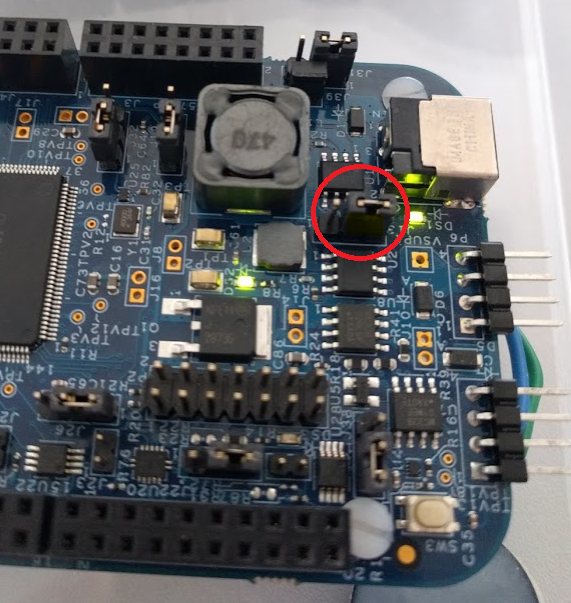

Step 1: Configure the MPC5744P DevKit board to use power from USB through the OpenSDA interface by setting the J13 jumper in the 2-3 position

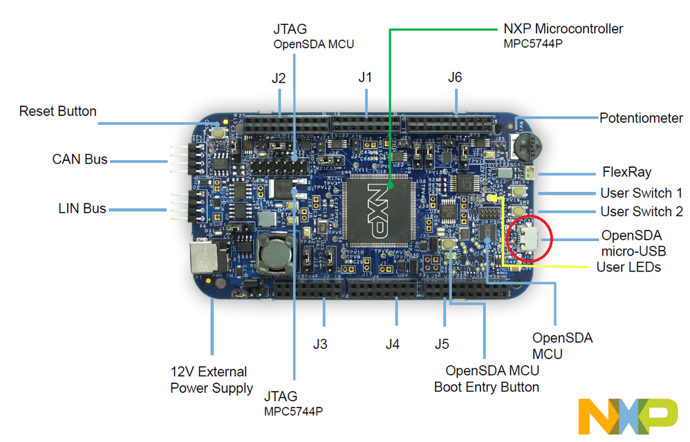

Step 2: Connect the Board with the Host PC via the Micro-USB connector

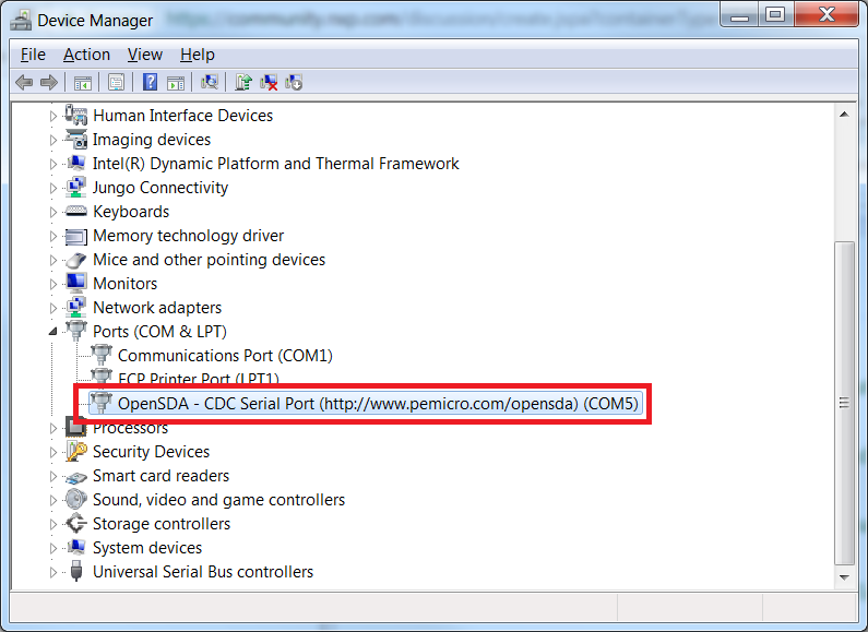

Step 3: Check your computer Device Manager to see if the Serial Driver was installed and configured correctly and note down the UART port assigned (e.g. COM5)

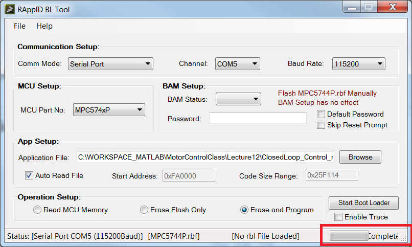

Step 5: Configure: Communication Protocol, Communication Port and select the MCU part you want to program.
Step 6: Load the *.mot file you need to program by clicking on the Browse button

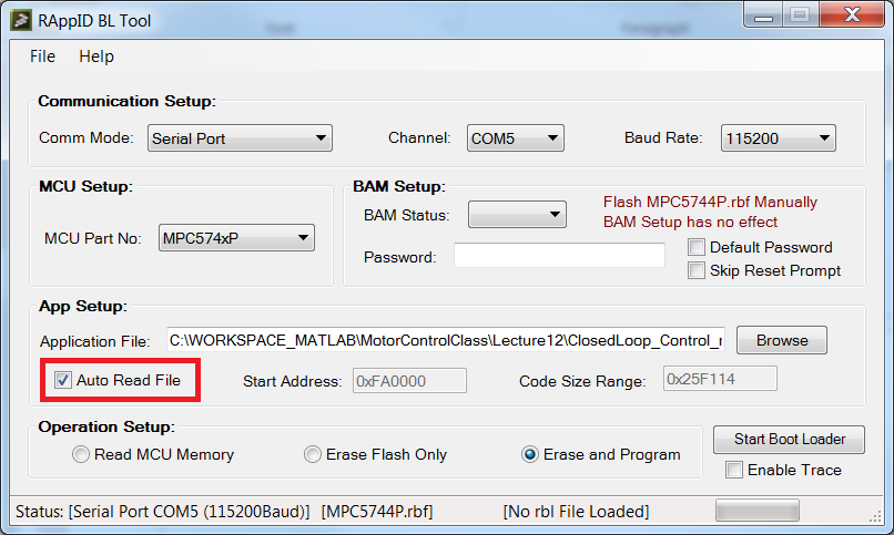

Step 7: Select Auto Read File option

Step 10: Wait patiently until the Erase&Program operation is finalized. The RAppID_BL.exe should show: Complete
Now your application is programmed into the MCU flash/ram memory. At this point you may change back the J13 to position 1-2 for external power supply.
