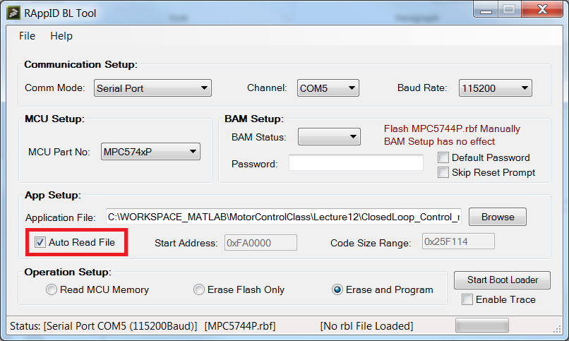

In case you want to program an existing application generated with Model Based Design Toolbox or any other IDE (e.g. the examples from the Motor Control Course) there is an easy way called RAppID Bootloader Tool.

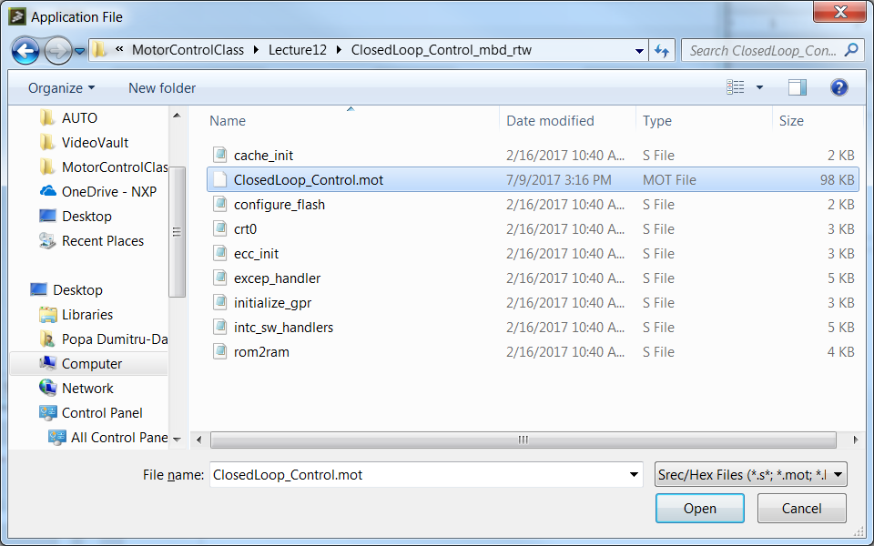

Let us consider the following example shown in Lecture #12 - Motor Control System. This lecture contains a zip file Lecture #12.zip that comes with a pre-compiled FLASH application that you can find inside the ClosedLoop_Control_mbd_rtw folder: ClosedLoop_Control_mbd_rtw\ClosedLoop_Control.mot
Question: How to flash the *.mot file into the MPC5744P DevKit?
Answer: Use RAppID_BL.exe application via Serial Port.
Prerequisites: This tutorial assumes you have already programmed the RBF file into the flash memory of the MCP5744P microprocessor. The RBF is the target microcontroller specific algorithm, which the GUI interfaces to for
boot loader operation. Check Video Link : 7766 starting at 2.04 to see how you can program the RBF.
Note!!!: There are different RBF files for DevKits vs. Development Board. Choose the appropriate one based on your setup. Special thanks to hjhjhj‌ for highlighting this aspect.

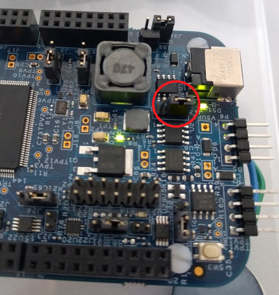

Step 1: Configure the MPC5744P DevKit board to use power from USB through the OpenSDA interface by setting the J13 jumper in the 2-3 position
Step 2: Connect the Board with the Host PC via the Micro-USB connector

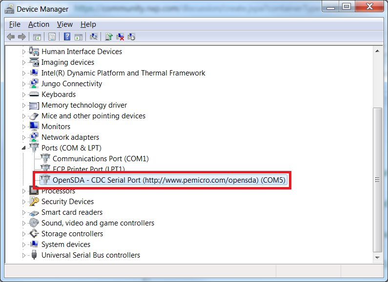

Step 3: Check your computer Device Manager to see if the Serial Driver was installed and configured correctly and note down the UART port assigned (e.g. COM5)

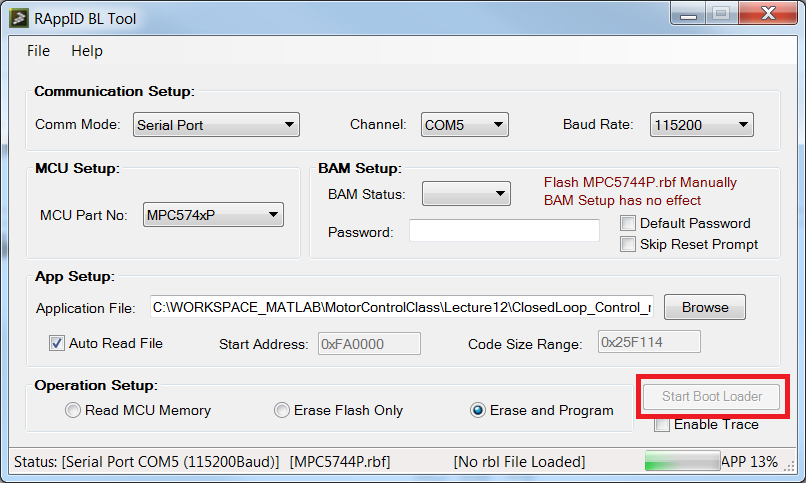

Step 4: Navigate to the C:\MBDToolbox\mbdtbx_MPC574xP\tools\BootLoader folder and run the RAppID_BL.exe application
Step 5: Configure: Communication Protocol, Communication Port and select the MCU part you want to program.
Step 6: Load the *.mot file you need to program by clicking on the Browse button

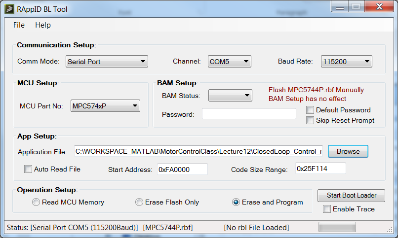

Step 7: Select Auto Read File option
Step 8: Reset the board by pressing the SW3
Step 9: Very quickly (within 5 seconds from pressing SW3) press the Start Boot Loader button
Step 10: Wait patiently until the Erase&Program operation is finalized. The RAppID_BL.exe should show: Complete
Now your application is programmed into the MCU flash/ram memory. At this point you may change back the J13 to position 1-2 for external power supply.

hjhjhj

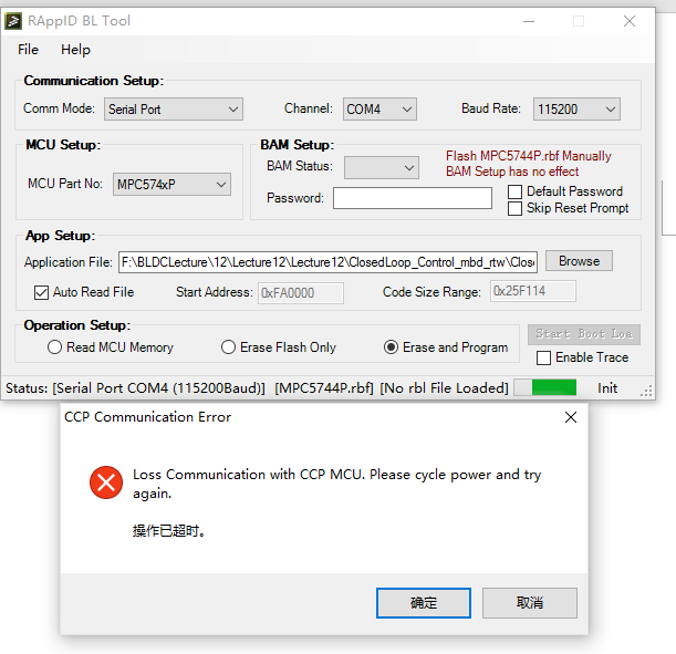

Hi Daniel,
    After programming the rbf file to MCU and doing from step1 to step10 as mentioned above,MPC5744P DevKit still fails to  communicate with Rappid bootloader GUI.Can you help me solve it?
Thanks!
 HJ
9,579 Views
Daniel_Popa
Hi HJ,
The RAppID_bootloader requires the RBF (boot loader flash algorithm application) to be flash into the MCU memory. This is done only once per each board.
The procedure of flashing the boot loader algorithm is described in the Motor Control Class: Lecture 3 - Input Commands  first video starting with 2.04 minute.
Please let me know if this works for you! If this is the root cause for your failure then i'll update the topic to be more clear about the overall procedure.
9,579 Views
hjhjhj
Hi Daniel,
    Thanks for your reply!The reason why my MPC5744P DevKit  fails to  communicate with Rappid bootloader GUI is that I programmed the MPC5744P.rbf to MCU,while the correct method is programming the MPC5744P_DEVKIT.rbf to MCU.
