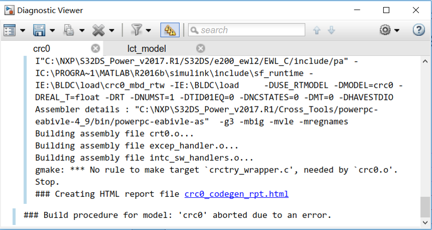

janexzj
Hello,@dumitru-daniel.popa
I found a problem using MBD Toolbox along with S-Function Builder. I could run or bulid the model which contained the block created by S-function builder without the block from MBD Toolbox. But if I put the the block created by S-function builder and the block from MBD Toolbox together and build the model again, there would be an error like the picture below. 'crctry_wrapper.c' was created by S-function builder.
I tried again using Legacy Code Tool to build a same block. I could also run or build the model which contained the block created by S-function builder without the block from MBD Toolbox. But there was a similar problem when I built the model containing the block created by S-function builder and the blocks from MBD Toolbox. 'CRC.c' was the c code used by Legacy Code Tool.
Is there any way to solve the problem?
