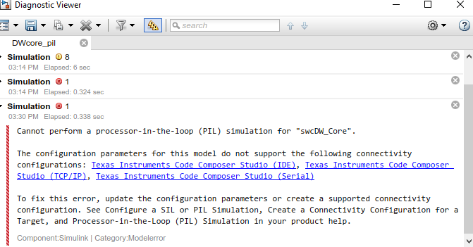

mahesh_narni
hello,
I am receiving this error while running PIL mode
could you please tell me solution  and how to rectify this issue

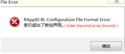

zongchen
Hello Daniel, When I was trying to generate code with matlab2017a, a message box came out. As no Evaluation Board was connected, then I press OK, another message box came out as below.
Do you know how to solve this problem? Thanks in advance.

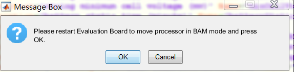

1506840872
Hey, 琛 踪
I am not NXP engineer but a developper working with MPC5744P as you.
I have encountered the same question as yours before. The first messagebox came out because you click the checkbox as below.
Actually, if you click the checkbox, the Simulink will start the Rappid Bootloader and enable the download process. If you unclick, the Simulink will just generate code, not downlaod.
When the messagebox came out ,the Simulink has been in the process of downloading. If the EVB is connected to the USB port, you can restart the EVB and then bootloader works.
The second messagebox came out because your EVB is not connected to the USB! The bootloader scan the USB port and found no serialport is connected, then the error messagebox came out.

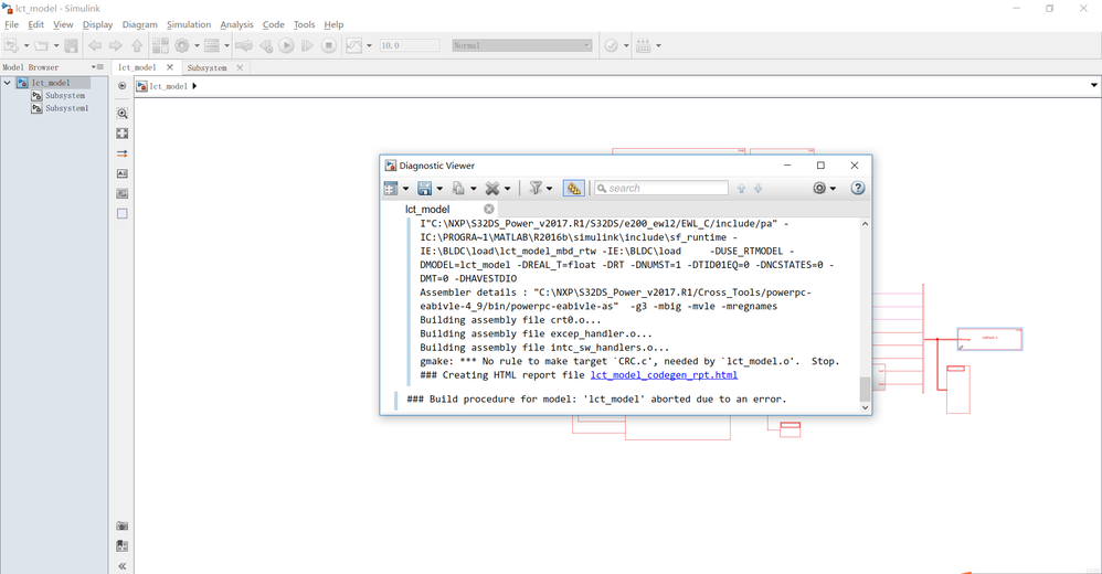

janexzj
Hello,@dumitru-daniel.popa
I found a problem using MBD Toolbox along with S-Function Builder. I could run or bulid the model which contained the block created by S-function builder without the block from MBD Toolbox. But if I put the the block created by S-function builder and the block from MBD Toolbox together and build the model again, there would be an error like the picture below. 'crctry_wrapper.c' was created by S-function builder.
I tried again using Legacy Code Tool to build a same block. I could also run or build the model which contained the block created by S-function builder without the block from MBD Toolbox. But there was a similar problem when I built the model containing the block created by S-function builder and the blocks from MBD Toolbox. 'CRC.c' was the c code used by Legacy Code Tool.
Is there any way to solve the problem?
