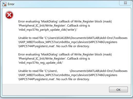

Dear mariuslucianandrei‌,
Thanks for the input but I get the error when I get the Write_Register block.
Somehow, It looks into MPC5748G folder instead of MPC5744P folder. It fails to find a mat file.
Best Regards
Abhishek

Hello again [email protected]‌,
I understand from gabriela_catana that this issue might be fixed by resetting the path for our toolbox - could you do that and let us know if it fixes it? We're going to investigate this issue nonetheless.
For resetting the path:
restoredefaultpath;
mbd_mpc_path();

abhishek_kumar1
Dear constantinrazvan.chivu
I did that and I get the Error as shown below

constantinrazva
Hello [email protected]‌,
It seems now it does not see the functions - did you run mbd_mpc_path as well? If yes, could you run again the same 3 commands as before (and write the values of devicePath, deviceName and peripheralList)?

abhishek_kumar1
Please see, I think restoredefaultpath somehow changed the target path.
>> restoredefaultpath
>> mbd_mpc_path
Undefined function or variable 'mbd_mpc_path'.
>> mbd_mpc_path()
>> mbd_mpc_path();
>> devicePath = mbd_mpc_find_target_path(fullfile('mbdtbx_mpc', 'devices'))
Undefined function or variable 'mbd_mpc_find_target_path'.

constantinrazva
You'll have to go to the root directory of the toolbox and run from there the mbd_mpc_path script. After you run it succesfuly, you'll no longer have the other problem.

abhishek_kumar1
It works
That is a strange behavior indeed - can you run some commands in the MATLAB terminal and share the output with us?
devicePath = mbd_mpc_find_target_path(fullfile('mbdtbx_mpc', 'devices'));
deviceName = mbd_mpc574x_get_target_mcu();
peripheralList = dir(fullfile(devicePath, deviceName, 'registers', '*.mat'));
If you could let us know what values these 3 variables have would be helpful in debugging this issue.

abhishek_kumar1
Please see the results
deviceName : 'MPC5744P'
devicePath: C:\Users\XXXXXX\Documents\MATLAB\AddOns\Toolboxes\NXP_MBDToolbox_MPC57xx\mbdtbx_mpc\devices\MPC5748G\registers
peripheralList is empty
peripheralList =
0×1 empty struct array with fields:
name
