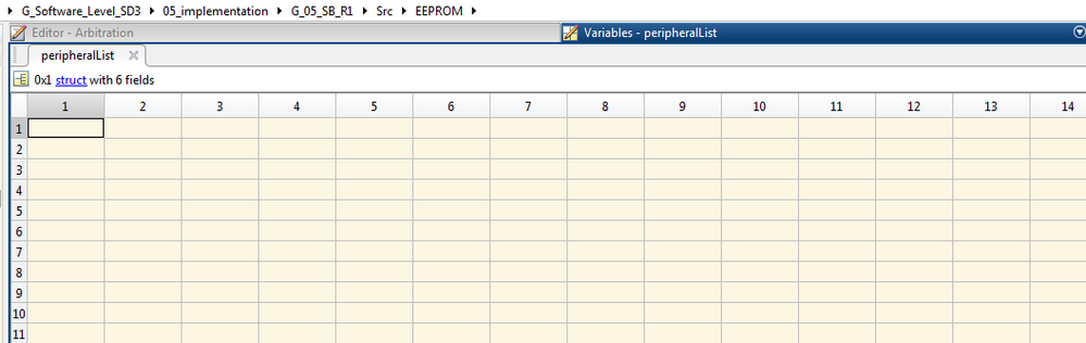

constantinrazva
Hello [email protected]‌,
It seems now it does not see the functions - did you run mbd_mpc_path as well? If yes, could you run again the same 3 commands as before (and write the values of devicePath, deviceName and peripheralList)?
Kind regards,
Razvan.

constantinrazva
That is a strange behavior indeed - can you run some commands in the MATLAB terminal and share the output with us?
devicePath = mbd_mpc_find_target_path(fullfile('mbdtbx_mpc', 'devices'));
deviceName = mbd_mpc574x_get_target_mcu();
peripheralList = dir(fullfile(devicePath, deviceName, 'registers', '*.mat'));
If you could let us know what values these 3 variables have would be helpful in debugging this issue.

abhishek_kumar1
Dear  constantinrazvan.chivu
Please see the results
deviceName : 'MPC5744P'
devicePath: C:\Users\XXXXXX\Documents\MATLAB\AddOns\Toolboxes\NXP_MBDToolbox_MPC57xx\mbdtbx_mpc\devices\MPC5748G\registers
peripheralList is empty
peripheralList =
0×1 empty struct array with fields:
name
folder
date
bytes
isdir
datenum
Beat Regards,
