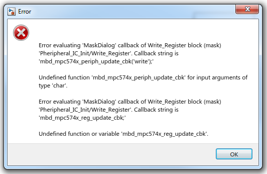

Dear mariuslucianandrei‌,
Thanks for the input but I get the error when I get the Write_Register block.
Somehow, It looks into MPC5748G folder instead of MPC5744P folder. It fails to find a mat file.
Best Regards
Abhishek

abhishek_kumar1
Dear constantinrazvan.chivu‌
I did that and I get the Error as shown below
Beat Regards
Abhishek

constantinrazva
Hello [email protected]‌,
It seems now it does not see the functions - did you run mbd_mpc_path as well? If yes, could you run again the same 3 commands as before (and write the values of devicePath, deviceName and peripheralList)?
Kind regards,
Razvan.

abhishek_kumar1
Please see, I think restoredefaultpath somehow changed the target path.
>> restoredefaultpath
>> mbd_mpc_path
Undefined function or variable 'mbd_mpc_path'.
>> mbd_mpc_path()
>> mbd_mpc_path();
>> devicePath = mbd_mpc_find_target_path(fullfile('mbdtbx_mpc', 'devices'))
Undefined function or variable 'mbd_mpc_find_target_path'.
5,482 Views
constantinrazva
You'll have to go to the root directory of the toolbox and run from there the mbd_mpc_path script. After you run it succesfuly, you'll no longer have the other problem.
Kind regards,
Razvan.

abhishek_kumar1
It works
