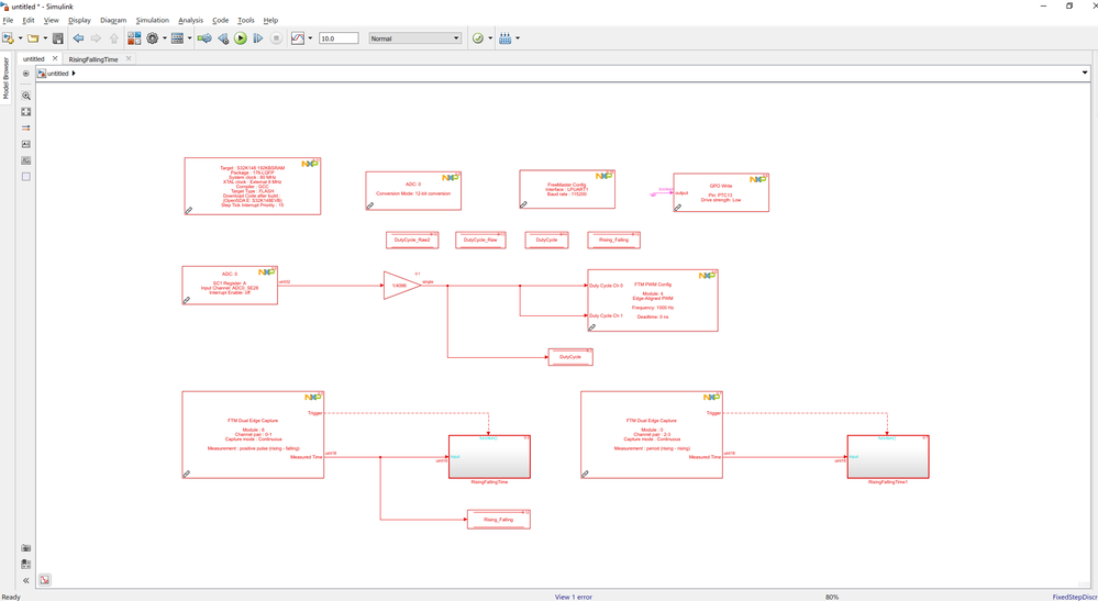

   I need to get two different time values which are Rising-Falling edge time and Rising-Rising time of one PWM signal. I'm changing duty cycle with potentiometer and assuming observe same duty cycle value from (Rising-Falling time)/(Rising-Rising time) calculation.
   Used different modules and different pins(I made connection of pins on breadboard with jumpers) caused error. I can take time values seperately but when I use two blocks at same time I have error. Can you please help me with this, thank you.

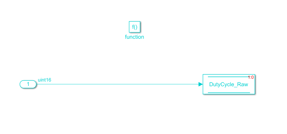

The complete model;
Function block;

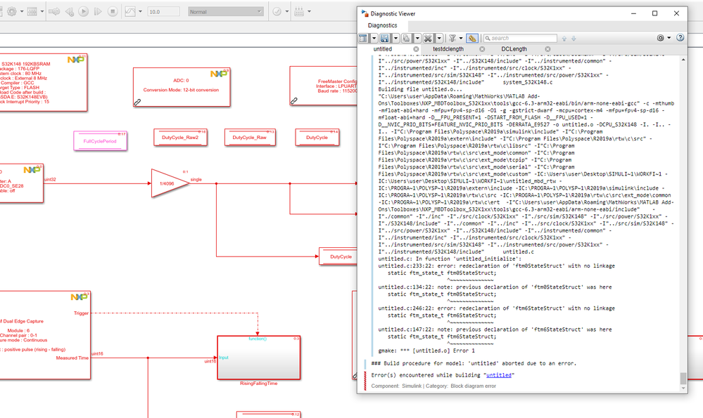

and error message on diagnostic viewer;
Thank you, regards

mariuslucianand
Hello [email protected]‌,
Oh, I see that you are using the previous version 4.1.0. Now, I remember that this issue has been fixed in the latest release. You can find the patch in this community thread https://community.nxp.com/message/1254393 . Please apply the files from here!
Hope this helps,
Marius

utkuckmgl
Hello mariuslucianandrei‌,
I directly changed version of toolbox and it's working perfect. Thank you so much
