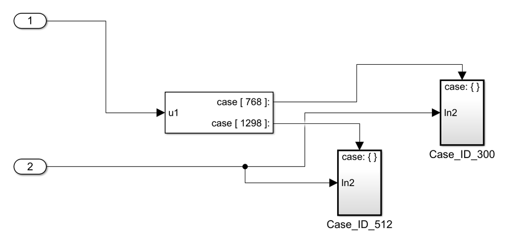

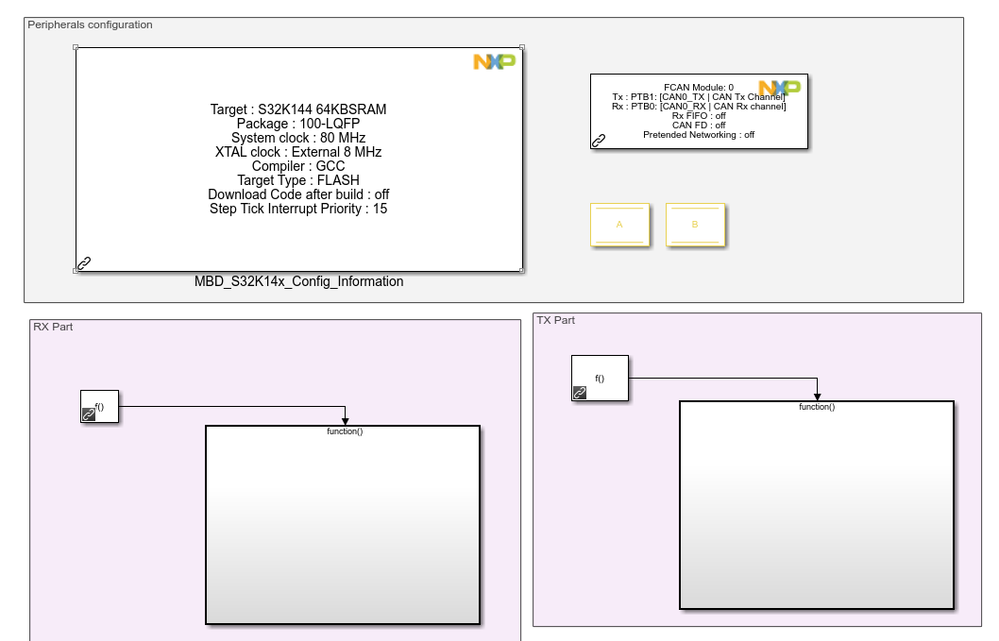

bearman_m
Hi Razvan,
I am honored to receive your reply. I want to receive messages from two different IDs and i want to send with two different IDs for what we have received. i cant find the way to give you my file. i will put some photos.
1.In the Tx part's function-call subsystem:
1.1 in the FCAN_Isr's function-call subsystem:
in the case action, we have two LED to toggle so we can know that we have received the messages, and  we save these received data to 2 memory blocks and them send them with two differet IDs.

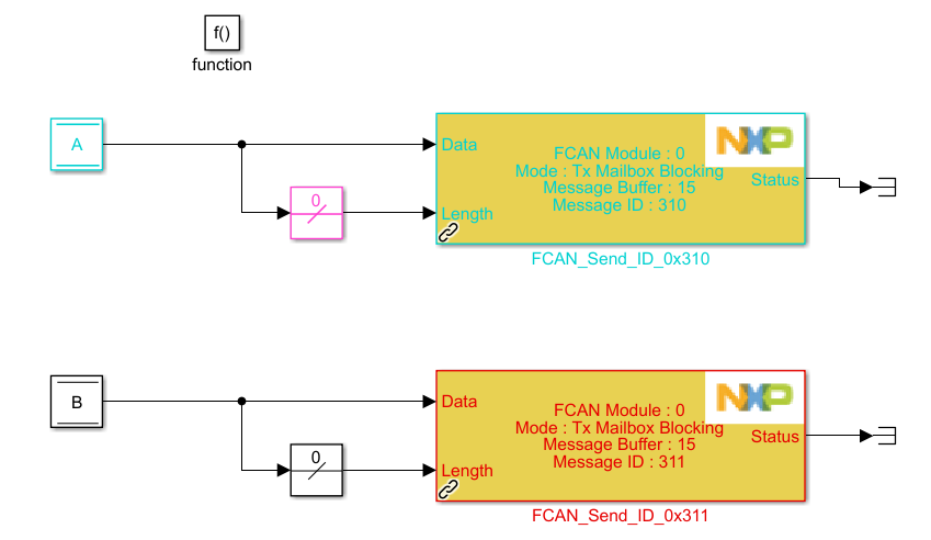

2.In the TX part's function-call subsystem:
we use two blocking TX parts to send these two kinds of messages.
The situation we encountered is that:
1. If we delete the whole "Tx parts", we can observe that the LEDs defined in 1.1 are Flashing, thus we konw that the MCU received the mesaages.
2. If we dont delete the "Tx parts", we can oberve that the MCU sents the 2 messages defind in 2., but LEDs are not flashing and the truth is , MCU can not receive messages any more.
We are new to MBDT and this kind of MCU.
I don’t know if what configuration caused this result, so I’m confused. Hope you can help me, thank you very much

constantinrazva
Hello bearman.m,
I would apreciate if you could send the model -- easier to follow than in the images. Can you select different message buffers (MB) for every block and see if you still have issues?

1750632
I had a try about that. It's useful to solve the problem. So I want to know the meaning of the "buffer". And what should we do if the number of messages is more than that of the buffers(add up to 32) ?

constantinrazva
Hello [email protected] ,
First of all, for each MB used you can select an entire range of messages - so you can map any amount of IDs to 1 MB. In the unlikely scenario where you have more than 32 ranges selected, you can multiplex a MB as long as you are careful in regard to the timing - you should make sure 1 operation is fully finished before the next one starts; otherwise it will just abort the first one.
If you want to read more about message buffers, you can check the reference manual for S32K1xx, in chapter 53.4.3 Message buffer structure and 53.5 Functional description.
