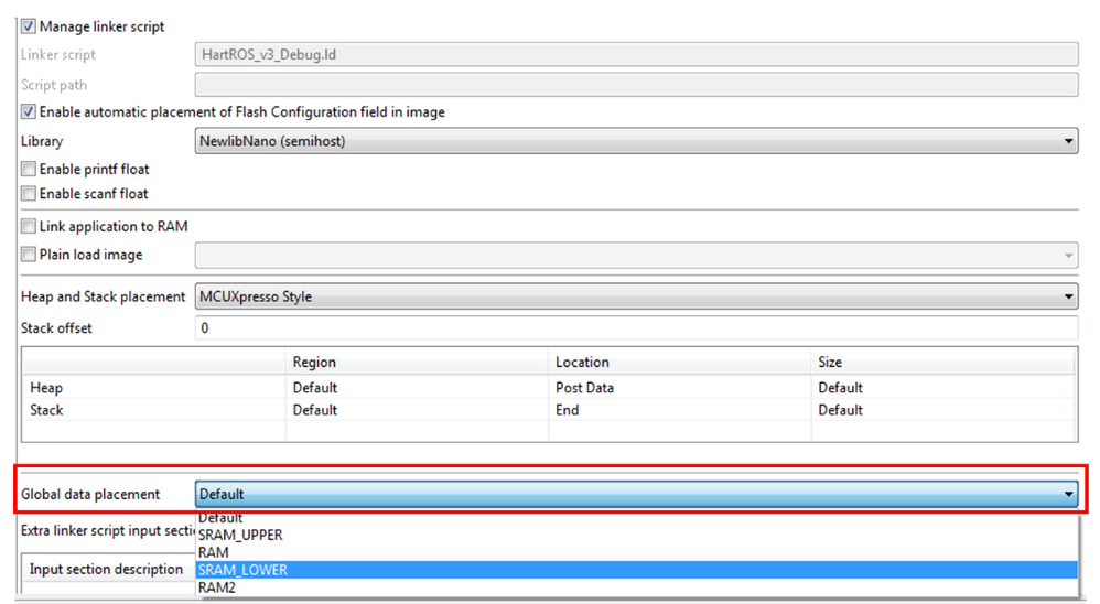

I'm new here. Maybe someone can help me.
I have the TWR-K60 Board and downloaded the SDK with FreeRTOS support.
I selected the lwip_tcpecho_demo_freertos demo. But to my suprise I cannot compile it.
Everything is fresh installed. I'm confused as I don't believe that NXP would offer a demo to the whole community that doesn't work.
It seems it doesn't use the lower RAM. What is wrong here?
Memory region Used Size Region Size %age Used
PROGRAM_FLASH: 56216 B 512 KB 10.72%
SRAM_UPPER: 81988 B 64 KB 125.10%
SRAM_LOWER: 0 GB 64 KB 0.00%
c:/nxp/mcuxpressoide_11.1.1_3241/ide/plugins/com.nxp.mcuxpresso.tools.win32_11.1.0.202001081728/tools/bin/../lib/gcc/arm-none-eabi/8.3.1/../../../../arm-none-eabi/bin/ld.exe: twrk60d100m_demo_apps_lwip_lwip_tcpecho_freertos.axf section `.heap' will not fit in region `SRAM_UPPER'
c:/nxp/mcuxpressoide_11.1.1_3241/ide/plugins/com.nxp.mcuxpresso.tools.win32_11.1.0.202001081728/tools/bin/../lib/gcc/arm-none-eabi/8.3.1/../../../../arm-none-eabi/bin/ld.exe: region `SRAM_UPPER' overflowed by 16452 bytes
collect2.exe: error: ld returned 1 exit status
FLEX_RAM: 0 GB 4 KB 0.00%
make: *** [makefile:46: twrk60d100m_demo_apps_lwip_lwip_tcpecho_freertos.axf] Error 1
"make -r -j8 all" terminated with exit code 2. Build might be incomplete.
21:56:48 Build Failed. 3 errors, 0 warnings. (took 8s.253ms)

danielchen
Hi Marcus:
I would suggest you put the global data to SRAM_LOWER. Please refer to below picture.
2,087 Views
tirak
Ok, this works. Thanx Daniel.

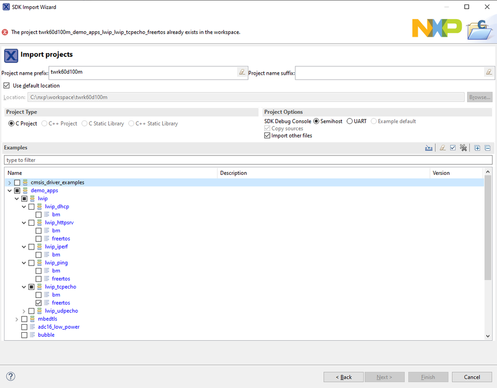

tirak
I used the SDK Builder on the Web-Site similar to the description in the followed link:
Generating a downloadable MCUXpresso SDK v.2 package
There you can select FreeRTOS
Than I downloaded it and simply drag and drop it to the project.
Then it offers you both, bm and FreeRTOS in the demo selections. But FreeRTOS doesn't work.

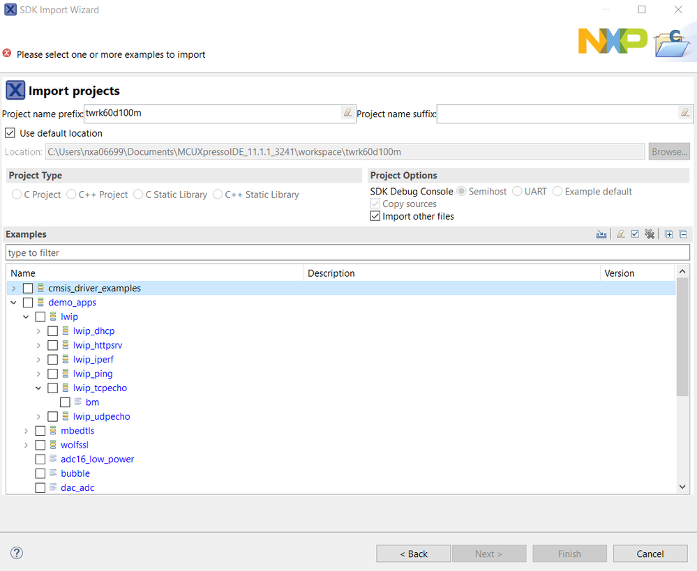

danielchen
Hi Marcus:
From MCUXpresso IDE, only lwip_tcpecho bm demo can be imported in my side. How can you import the freertos version?
