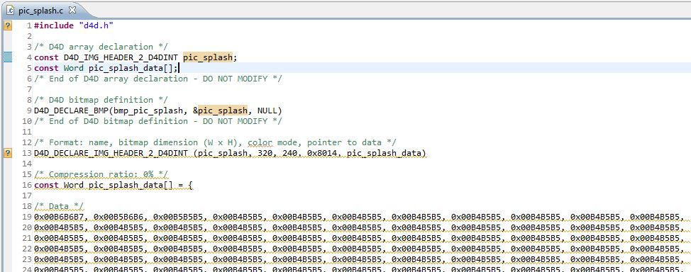

jimmylim
Hi Petr,
     Thanks, the code sample code work well, i am able to read the 24bits bmp image file from the SD card and display on the LCD, but i failed to display the 24bits bmp from the C array image (which generated by eGUI Converter Utility 3.0Alpha in 24bit Color (8-8-8) with compression OFF) from the internal flash, the LCD just showing blank and with mouse cursor. Below is the generated code, i would like to ask do you have any working sample code which able to display 24bits bmp from the C array image?
     I also set #define D4D_BMP_16MNOPAL_ENABLE    D4D_TRUE
    Code generated by eGUI converter:
   Declare for screen:
   D4D initialization:
hope to here from you soon, or anyone else have answer for me, thanks!

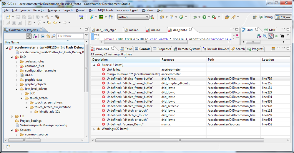

ioanacroitoru
Hello Petr,
This code compiles with 17 errors on my side.
For example in d4d_font.c at line 740 I get:
Undefined : "d4dlcd_frame_buffer"
Why is that? d4dlcd_frame_buffer is not defined. Where should I put it?

Gargy
no idea :-(, Post here the screen shot of error.
Petr

ioanacroitoru
Hi Petr,
Sorry for the delay. I didn't get an update that you reply to me.
Anyhow here is the screeshot (I'm using twrk60j120m):

Gargy
it looks that you don't have added into your project files of frame buffer and also CRTOUCH driver.
Just add it to your project and recompile.
Petr

Gargy
do you have added in your project Frame buffer driver? Bacause this caused to select in configuration file that you are have selected Frame buffer driver like this:
#define D4D_LLD_LCD d4dlcd_frame_buffer   // the name of low level driver descriptor structure
But this files are not compiled in project. I mean files:
d4dlcd_frame_buffer.c
d4dlcd_frame_buffer.h
Please check this.
Petr
