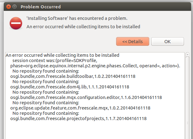

i'm trying to install the MQX Eclipse plugin 4.0.2 for the DS-5 Vybrid Tower System Starter Kit Version 5.22.0 under Ubuntu 14.04 running in a virtual machine. During the installation process I get the error message you can see on the attached image.
Do I have the rigth plugin version? What can I do to solve this problem?

tim_09
Hi Alejandro and Richard,
thanks for your help. Installing the plugin from the community in a clean install of DS-5 helped me solving this problem. Seems like everything works fine now.
Alejandro you could close the service request now as the solution solved the problem.
Thank you a lot. Great support.

richard_stulens
Hi Alejandro,
We do not maintain that plugin anymore, but out engineer in the MQX team checked it anyway.
Here's his findings:
I’ve tried to install version of “MQX support” plug-in from this thread (https://community.freescale.com/thread/323233) into clean install of ARM DS-5 v5.22.0 (build: 5220021) under Ubuntu 14.04 and Windows7 without any problem and plug-ins works fine.
I would suggest to try install of plug-in again in clean DS-5 because “No repository found containing” problem makes no sense when all mentioned missing plug-ins are bundled in “MQX support.zip” file (which is in fact Eclipse update site containing these plug-ins).
Richard
