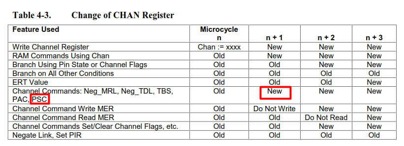

We are using MPC566 and TPU which is running at 28MHz. In one of our entry point functions we are writing below code. The pin is getting set in immediate instruction after changing the channel using chan_reg.
au chan_reg := p_low.
chan pin := high.
The question is the new channel’s pin will be set to high or the old one’s?
1,321 Views
davidtosenovjan
An answer in NEW one.
(I am apologizing for the previous response, I was misinformed by our eTPU expert, but now it is clarified.)
