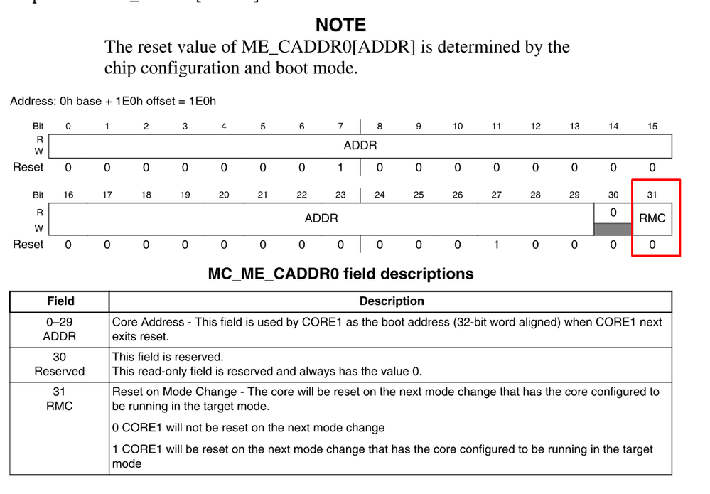

I need to reset core0 alone of MPC5746R using SWT without using FCCU .Please give the detailed steps to be followed.

Yes tell me how to reset core1 seperately.

When activating core1 set in its boot address RMC.
However I have made tests and the RMC set in not resetting the core on mode change.
So now I must say, I see no way how to reset cores separately.
I will ask in application team for confirmation and possibly reference manual description update.

Do you mean by core0 whole micro?
Because there is only one reset generation module and I can imagine that is possible to reset core1 separately. But not core0. On core0 reset whole micro will be reset.
Please specify the details what are you trying to achieve.
