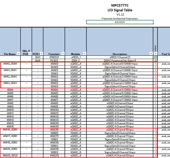

Hello everyone,
To use sigma delta adc for my CPU called MCP5777C, I looked at the SDADC pins. According to reference manuel, there are analog pins from AN0 to AN7 for sigma delta ADC. However, I cannot understand which I/O ports have this function. For example, If i saw ANB0, I would understand, it is port B.
Could you help me about that?
2,089 Views
davidtosenovjan
Hi, it is explicitly defined in the excel sheet embedded in the device's RM

berat24
Thanks a lot:)) @davidtosenovjan
