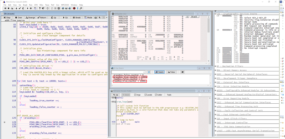

Hi team,
Customer currently do CSE key load&erase( with a for loop, first load key and then erase key about 10000 times) test experiment.
But after the 10000 times test, and power on the MCU again, the key can not be loaded or erased any more and the CSE_ECR = 0x02 reported command sequence error, and other CSE command also have this error when send to CSE. And CANCEL is the only command the CSE will accept without 0x02 error. This issue also same with this ticket, but it doesn't have a correct answer: https://community.nxp.com/t5/MPC5xxx/MPC5777C-CSE-Problem/m-p/589107#M4239
So question is how to handle this issue, since in this case the key can not be loaded or erased any more and the CSE command also can not be accepted by CSE core.

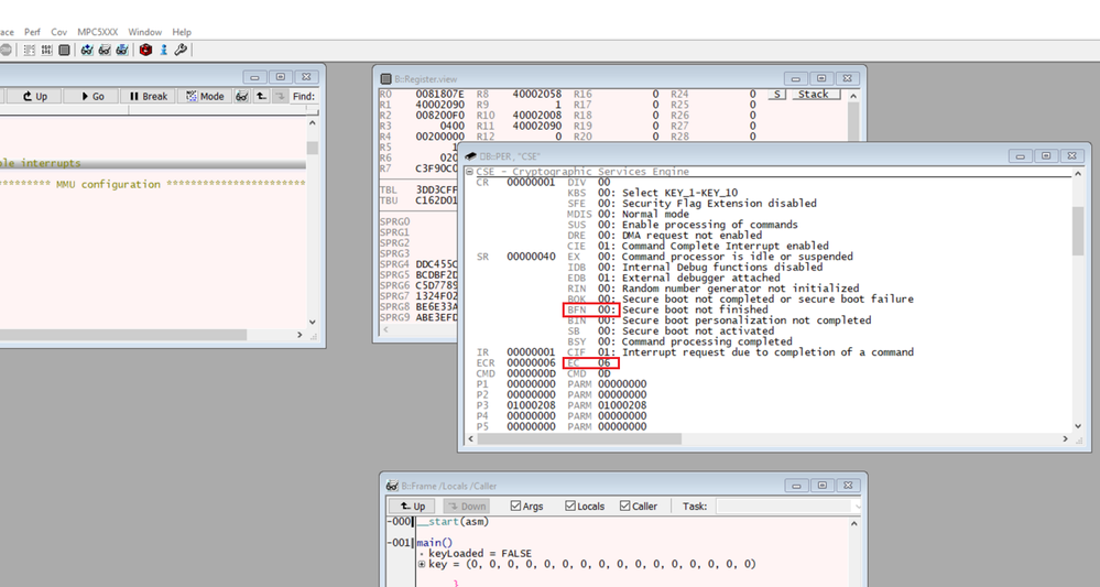

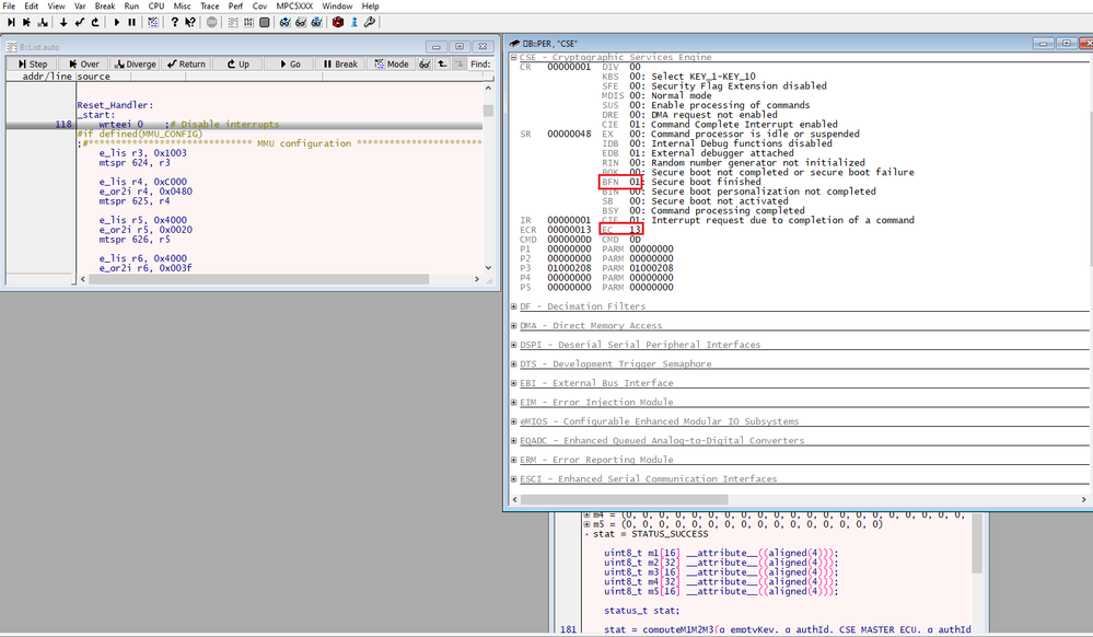

I compared the normal(replaced with new chip on EVB) and issue chip and found that the SR_BFN bit and CSE_ECR bit are different, SR_BFN bit means secure boot finished but i don't enable the secure boot on the issue chip.
error one:
normal one:
