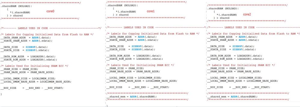

ronliu
Thanks Martin,
I found that it was running correctly if I just only locked and unlocked the gate 0.  As the picture shows,
But if I tried to read or write data in the shared memory. The project jumped into the IVOR1_Vector(). So I doubt that if there is something wrong with the configuration about link files.
1. This is the configuration about mem.ld.
My project is that each core gets 128K * 3 = 384K RAM. The rest 128K is used as shared memory.
CORE0    0x40000000 ~ 0x4005FFFF
CORE1    0x40060000 ~ 0x400BFFFF
CORE2    0x400C0000 ~ 0x4011FFFF
SHARED 0x40120000 ~  0x4013FFFF
2. I added the parts between red lines in every sections.ld.
3. The shared memory structure is like that. There are 8 bytes in it. The total size of shared memory is 128K. But I only use 8 bytes now. I think it is not important.
In the first core, I create a new structure in the shared memory  and write some new data to 'gCANCmd'.
Then I declare the shared memory in the second core and read data from '_shared_mem[]'
Especially, I really lock and unlocked the GATE_0 when I try to execute the process of reading and writing.
So the problem is why it goes wrong when I am using the shared memory. Any ideas?
Ron

martin_kovar
Hi Ron,
from the screens you sent me it seems, linker file is OK. Is it possible for you to share your project here? I need to check the whole code.
