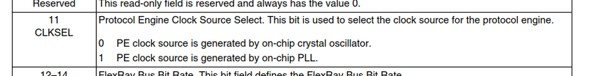

MPC5748g Flexray clock using PLL how to set

Yes, it is the configuration
1,982 Views
davidtosenovjan
You may have two options:
- either 40MHz directly feeded by crystal oscillator
- or 80MHz clock feeded from PLL
I am recommending to use following clock configurator:
https://www.nxp.com/docs/en/application-note/AN5392.pdf

Hello, davidtosenovjan
    Thank you for your answer.
     If FR_MCR[CLKSEL] is 1 in MPC5748, check whether other configurations are required in flexray PE clock?  I have configured FS80=80MHz.
1,959 Views
davidtosenovjan
