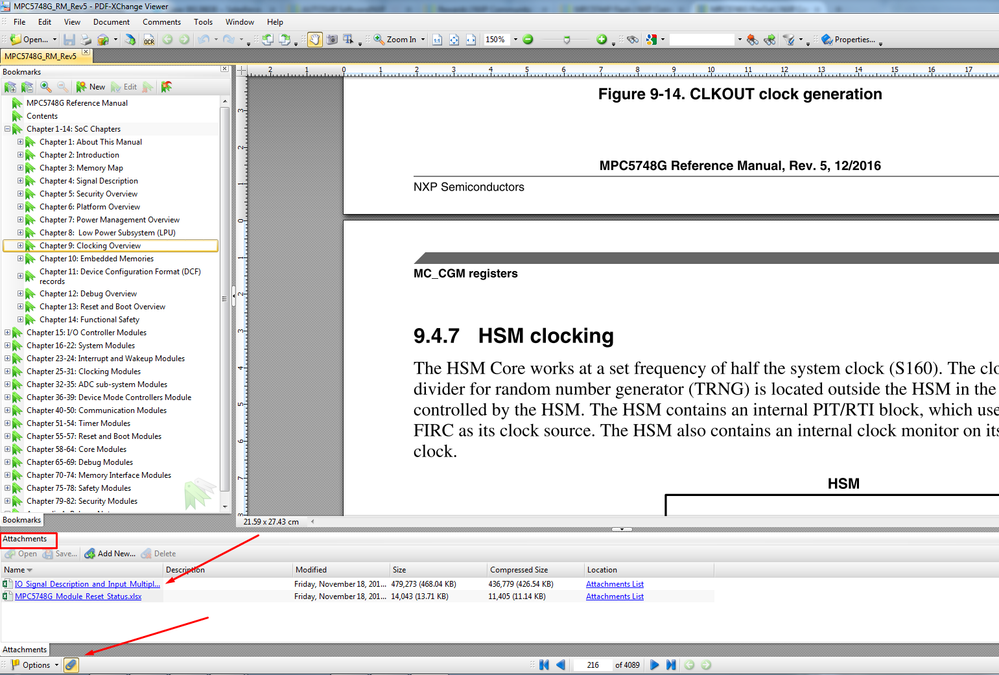

I'm new with Freescale Chips in development. Where can I find Pin-Out tables for MPC5748G 176Pin LQFP? There are none at the Freescale download-area...

It is attached in Reference manual.

It is understood, that the signal description "is attached in Reference manual".
Nevertheless, I did not find any place to download this Excel file. Is it only available under an NDA?

It is an embedded attachment in reference manual pdf format.
Please find in your pdf browser,viewer or editor the paperclip icon.
Under is are embedded attachment.

The attachment to the rev.5 reference manual document (IO_Signal_Description_and_Input_Multiplexing_Tables.xlsx) has errors in the pin names for both the 176LQFP and the BGA256 packages.  The rev.4 reference manual does not have these errors.  The bad names for 5 of the pins are all "#REF!", which is an Excel error for a bad cell reference.
