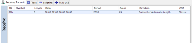

Configured MPC5744P as Master and flased S32 design studio LIN Master code, Different controller as slave and will respond to the ID added in the filter (ID=0x30,DATA=0x00,0x00,0x02,0x00,0x00,0x00,0x00,0x00)  and I connected PLIN Viewer to view LIN frame.
Master Sending 0x30h Identifier to receive data from slave. I'm able to viewe the slave response data in PLIN viewer. But MPC5744P waiting in a while loop while (!LINFlexD_0.LINSR.B.DRF); /* Wait for data receive complete flag */. DRF is not triggered and BDRL, BDRM not updated. it's value remainds 0.

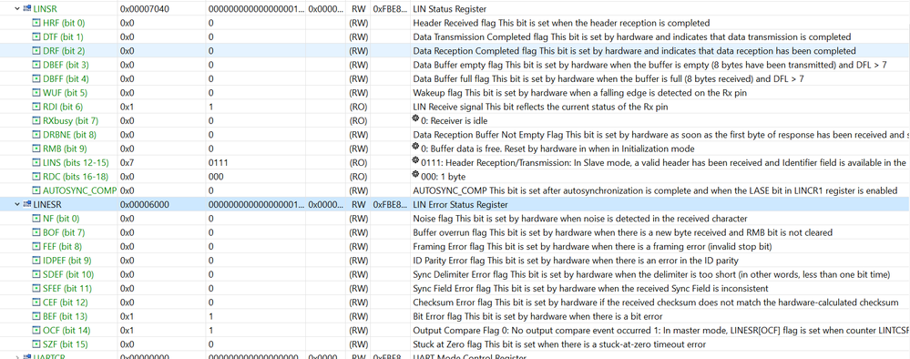

I removed from Loopback mode and configured LINFlexD_0.LINCR1.R = 0x00000390 and tried. But not received the data. Struck in the same place while (!LINFlexD_0.LINSR.B.DRF); /* Wait for data receive complete flag */.
LINSR shows 0x00007040 and LINESR shows 0x00006000.

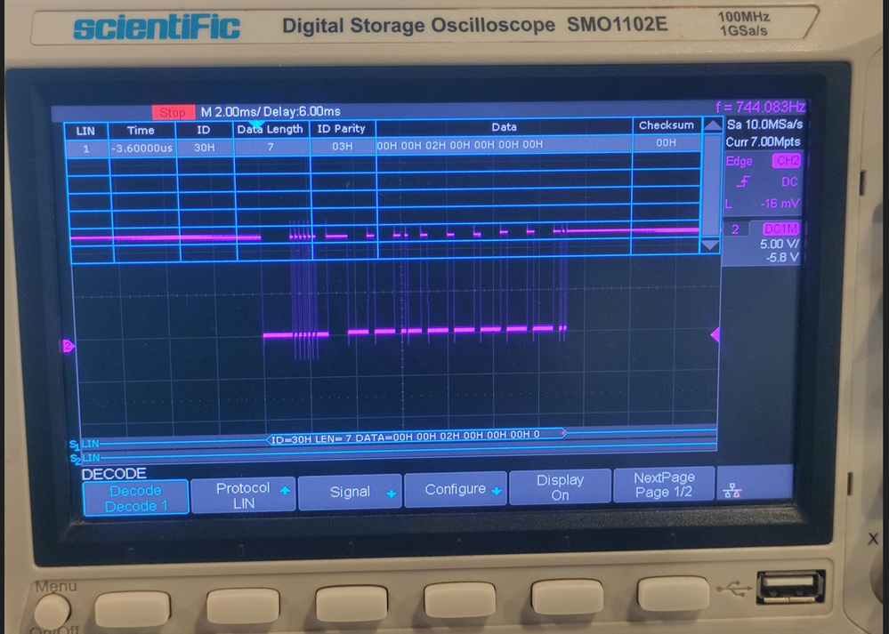

I'm able to capture the slave response in oscilloscope and PLIN viewer. In MPC5744P DRF bit is not triggered. Kindly help me to fix the issue.

PetrS
what is a board exactly (name, rev.)? Show LINCR1 as well.
Bit error is detected for some reason, so try to measure LIN and master TXD/RXD signals to be sure transceiver is active.

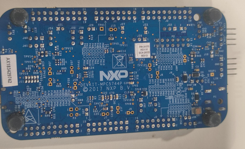

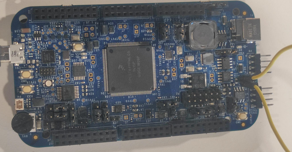

Vennila
I'm using DEVKIT-MPC5744P 2017 NXP BV(REV-D which is on the white label). LIN transceiver placed on the board is TJA1021 NXP.
LIN RXD and TXD Signal captured in Logic Analyser. Received the expected Slave response(data: 0x00,0x00,0x01,0x00,0x00,0x00,0x00,0x00) in RXD.
D4 - TXD, D5 - RXD.

4,204 Views
PetrS
ok, this looks normal. But not sure why bit error is set. Is baudrate properly set?

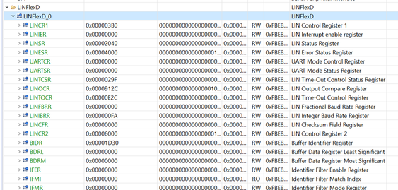

PetrS
interesting, I can recommend to place breakpoint before frame sending and check all setting if it is expected (pins, clock, LINflex,..). If you do not find anything wrong, then share your project so we can test.

Vennila
Hi Petr,
I'm didn't find anything worng before send a frame. all register values present as configured values. shared the project file and configured a baud rate as 9615bps. Please give a fix for that debug mode.
