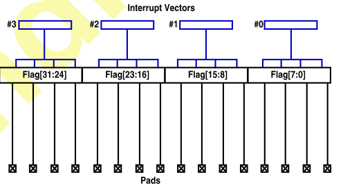

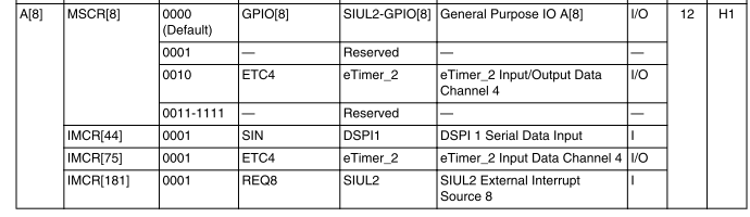

martin_kovar
the problem you deal with is little bit complicated, but I will try to explain.
SIUL2 external interrupt IRQ0 causes fault NCF32 in FCCU. This is the NCF32 fault description:
Error input pin of this device. Because of the lack of a dedicated pin for this purpose, SIUL2 External Interrupt_0 can be used to indicate if any other MCU is going into Error state. Note: If interrupt is configured as the reaction of this NCF then the interrupt controller may observe two interrupts one due to FCCU and another due to the SIUL IRQ[0]. So, appropriate configuration must be done.
By default, this NCF32 is enabled in FCCU (see registers NCF_E1), but no reaction is set.
FOSU is enabled by setting any bit of NCF_E and correspondingly same bit in any of the NMI_EN, IRQ_ALARM_EN, EOUT_SIG_EN or NCFS_CFG (in your case it is NCFS_CFG[0] - watchdog, NCF14).  As soon as external interrupt occurs, FOSU triggers its own internal watchdog and waits for NCF32 fault reaction. Because this reaction is not set, device is reset after FOSU internal watchdog timeout.
There are three ways, how to resolve your problem:
1) Disable the NCF32 fault in NCF_Ex register.
2) Configure reaction for the NCF32 fault (interrupt)
3) Use IRQ1 external interrupt instead of IRQ0. Do not forget about external interrupt routing to INTC controller.
Use the pads, which have function REQ8 and higher. These are routed to IRQ1 - IRQ3.
Hope it helps.
Martin
