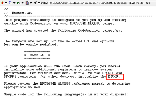

Hi, My microcontroller is mpc5634m. I'm developing bootloader. I use the program  got from the forum and modify it,now I can use serial port to download bootloader to RAM and run it in BAM mode. When I execute the program in RAM, I can brush the user application program to the flash address of 0x10000. But when I use the program running in RAM to brush bootloader to flash (0x0000), the program will not be executed. I don't know why? I made the following attempts:
1. Change the address of the user application program to 0x0000, and the program will not be executed
2. Change the address of the user application program to 0x10000, and the program will be executed
3. Change the address of the user application program to 0x20000, and the program will be executed
4. Change the address of bootloader to flash(0x10000), and the program also not  execute(like flash address 0x0000)
Do that need any other settings?
I noticed in the note that if the program swipes to the flash initialization register:
Is there anything to do with this register? I compared the user application program with the bootloader program, the operation of this register should be the same, but the application program can run, but the bootloader does not.

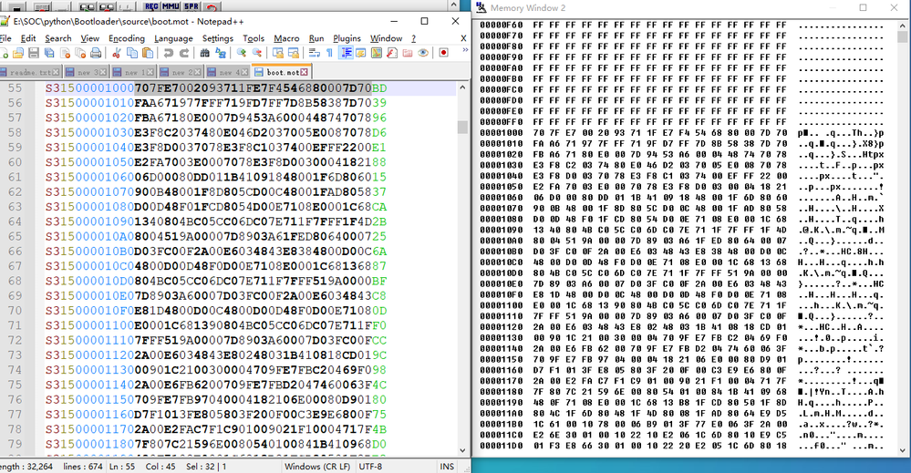

1. Are those applications working when you load them via JTAG, not by the bootloader?
2 Once the applications are loaded by your bootloader, did you try to check the content of flash by debugger? In other words, is the application loaded correctly?
I'm asking because I do not understand from the description if it is problem of bootloader loaded by BAM or problem of loaded applications.

1. I tested to change the startup address of the user application to 0x00000000. After downloading through JTAG, the program can be executed. In the program, I set to print a line of string through the serial port, and I can see the string printed circularly. But the same .mot file, after I download it to flash through bootloader, there is no string printed out, but I feel that the program may have been loaded into flash, because according to previous tests, if there is no program in MCU, when I send characters to MCU at 115200 baudrate, MCU will always reply with a "?"  in response, whatever I send is a reply to this character.But now when I send any character, there is no response,
2. I use CodeWarrior v2.10, I don't know how to debug .mot file loaded into MCU program by upper computer, because once I click "debug", it will reload the program into MCU through JTAG, I'm not very familiar with it.

Flash data and .mot original file are the same, I think the program has been loaded into flash, but I don't know why it is not executed, no response.
4,157 Views
lukaszadrapa
once it is loaded to the flash, run CW_ICDPPCNEXUS as mentioned above and step the code to see what happens and where it crashes.
