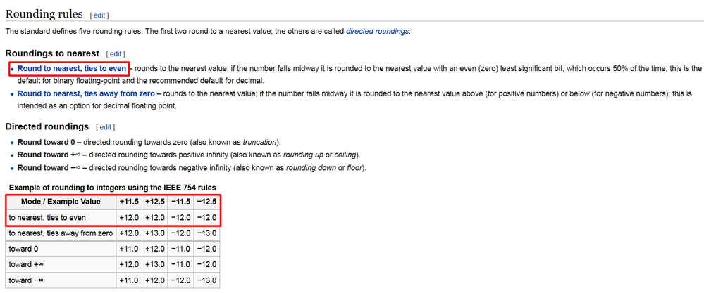

We've used "efsctsi" assembly instruction on MPC5xxx MCU and "fctiw" on MPC83xx PowerQUICC II Pro CPU (having SPEFSCR[FRMC] / FPSCR[RN] = 00 (round to nearest)) and we were surprised of the result. We were expecting the following 32bits floats to be converted to the following integers:
. 6.5 -> expected=7 ; obtained=6
. 7.5 -> expected=8 (obtained that)
. 8.5 -> expected=9 ; obtained=8
. -6.5 -> expected = -7 ; obtained = -6
. -7.5 -> expected = -8 (obtained that)
. -8.5 -> expected = -9 ; obtained = -8
So, is it possible to use these instructions to round floats to integer including round +x.5 to x+1 and -x.5 to -x-1? Or are these instructions performing a base-2 rounding rather than a base-10 rounding?

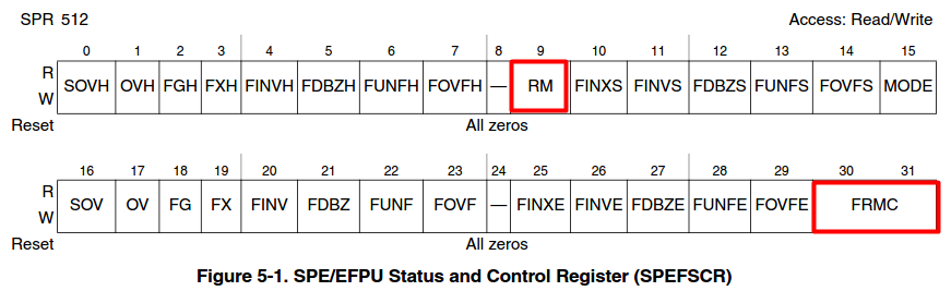

I can confirm observed behavior. I have test with e200z759. It is mode "Round to nearest, ties to even" and it seems to be fixed on this core.
IEEE floating point - Wikipedia, the free encyclopedia
e200z760 has following SPEFSCR[RM] affecting rounding mode. Note that FRMC bit also influence float to integer rounding behavior so here you should be able to configure all options from table above.

Thanks. So if using e200z760 (which is used in very few MCUs though...), then setting SPEFSCR[RM]=0 and SPEFSCR[FRMC]=00 would fix the problem.
