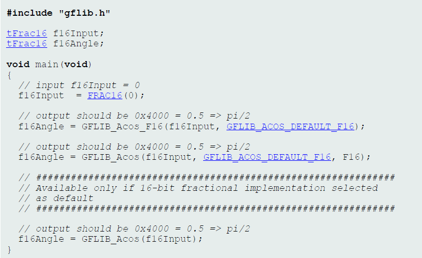

While the example on the user guide is very simple, but it causes the same errors as above.pastedImage_15.png

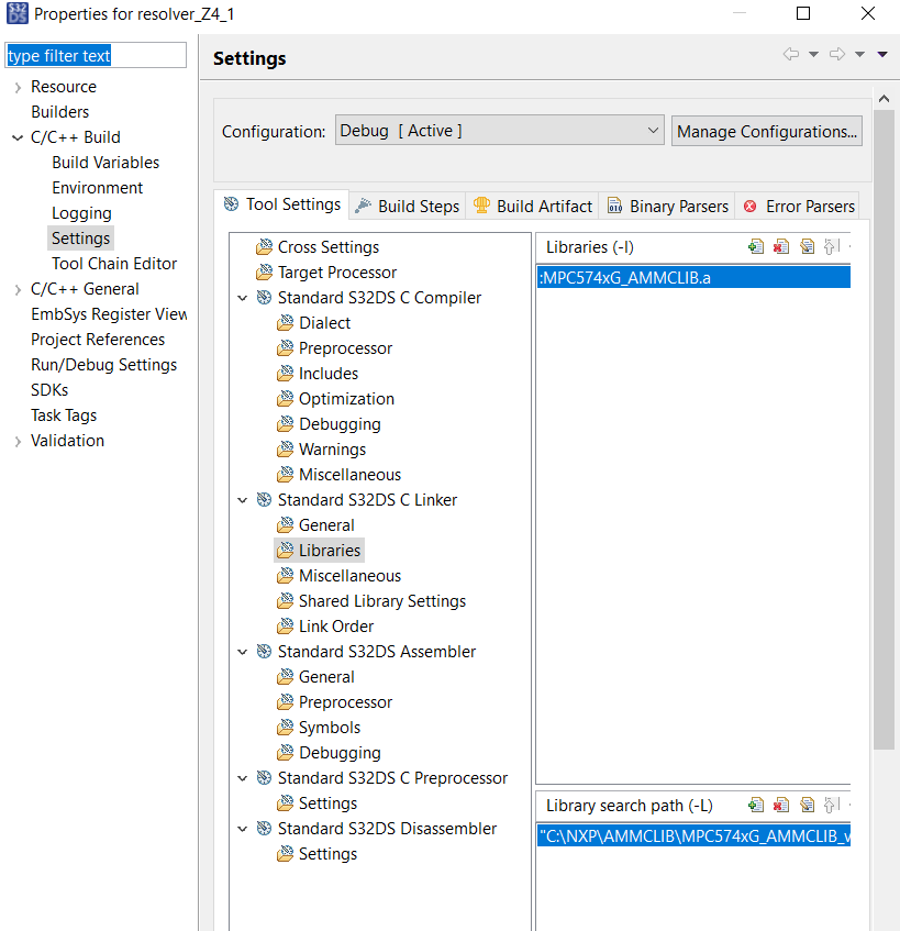

I have downloaded the latest version and installed it by the user's guide. And now it only shows 1 error message when build.
which is very strange, because I already add "mpc574xG_AMMCLIB.a" in the library. Please see the screenshot below.

petervlna
regarding error I see only way that you have incorrectly added Library search path - in your screenshot is missing the end of path, so it is not clear if you added correct path including the selected core (e200z2 vs e200z4).
If you have separated project for each core you have to set the library path for each core for those projects.
EWL vs bewlib - this is usually selected in project wizard which will ensure all necessary settings.
