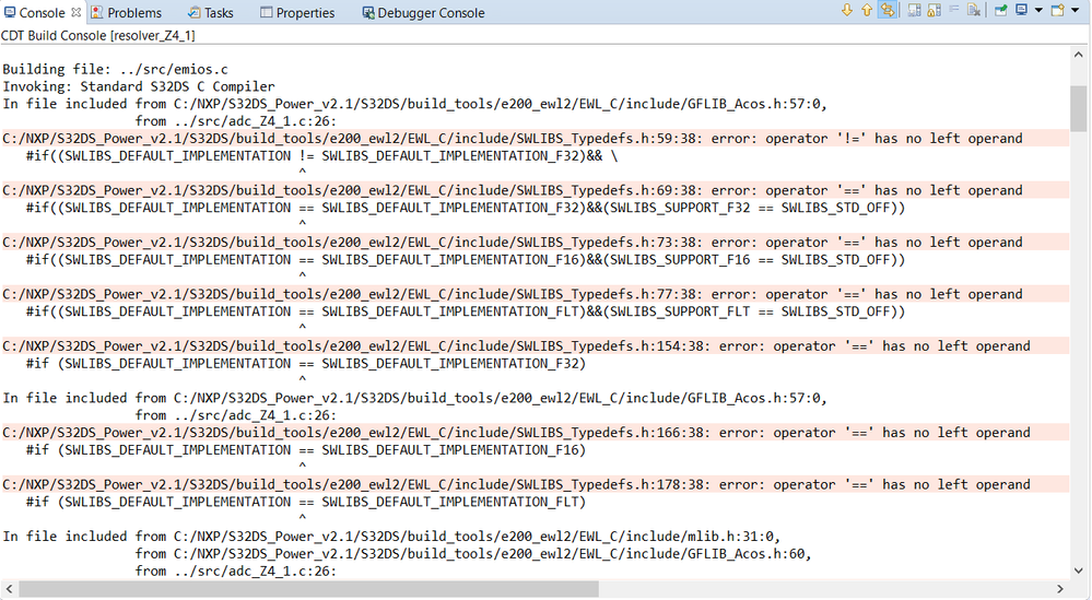

But I got many error messages while I'm only using the function of "Acos", does anyone know the reason? I'm posting my code and error messages as below.

Error message:

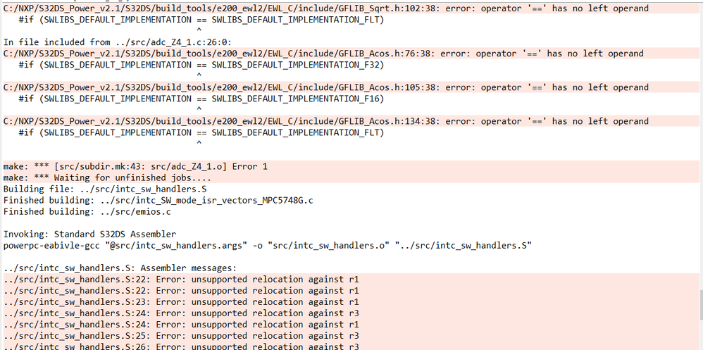

And there are many similar prefix "SWLIB_xxx", "MLIB_xxx", "GFLIB_xxx" with the following error "error: operator '==' has no left operand" shown in the console.
While the example on the user guide is very simple, but it causes the same errors as above.pastedImage_15.png

petervlna
  1. It is necessary to set the macro SWLIBS_DEFAULT_IMPLEMENTATION in the file SWLIBS_Config.h (see AMMCLIB User's Guide for help).
  2. The AMMCLIB integrated in the S32DS is obsolete. Download the current version from www.nxp.com/AutoMCLib.
  3. Even though the S32DS project wizard allows users to use the EWL library together with AMMCLIB, this combination is actually not supported. Use newlib instead.
regards,
Peter

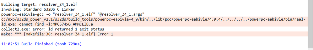

jzhang1
Thanks for your response.
I have downloaded the latest version and installed it by the user's guide. And now it only shows 1 error message when build.

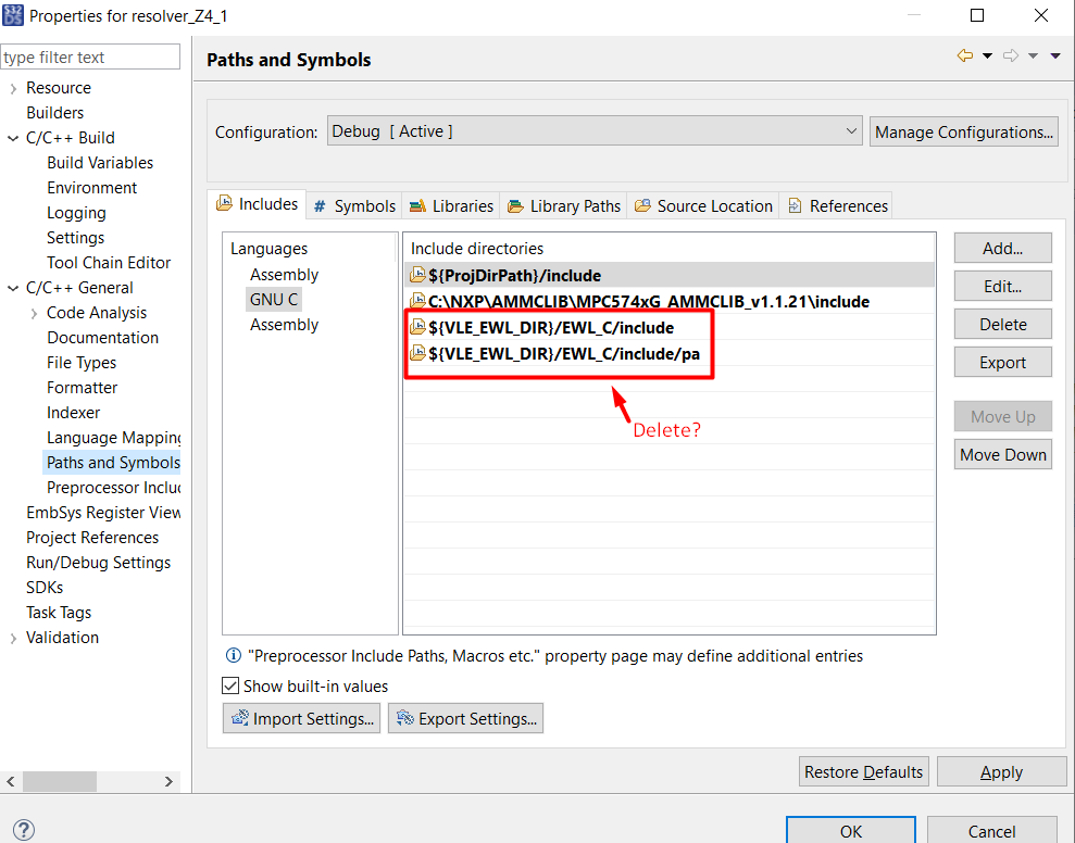

which is very strange, because I already add "mpc574xG_AMMCLIB.a" in the library. Please see the screenshot below.
For the 3) you mentioned, do you mean I have to delete the EWL library while I'm using the Ammclib? Or just EWL and AMMClib cannot use it together?
Original code has modified to define the "SWLIBS_DEFAULT_IMPLEMENTATION".
