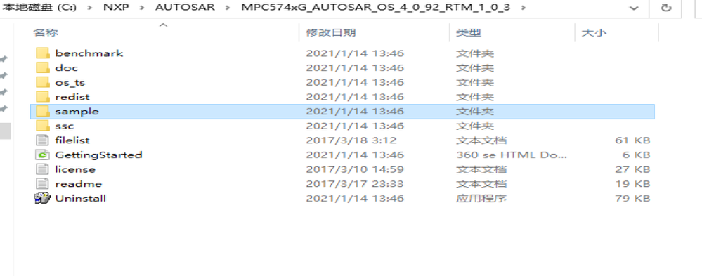

Can AUTOSAR_OS build an SDK package like freertos and compile directly on S32DS without EB Tresos generation code
2,910 次查看
petervlna
AUTOSAR OS configuration must be generated from Tresos.
There is AUOTSAR OS makefile project supplied, I recommend you to have a look at it.

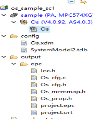

lubo_NEW
That folder is the generated code that EB Tresos got, I can't find it   Thank you for your replynn22.png

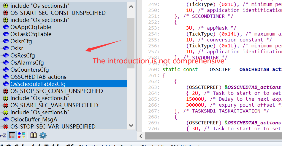

lubo_NEW
Thank you for your reply. I haven't found many of the OS examples you mentioned, or reference examples or generated configuration files.
I want to add the generated configuration file into the DS32DS project manually.
I looked at the generated files and configuration files and some of them did not seem to have a description like the EVENT

petervlna
The Tresos only generate configuration files. It is customer responsibility to put them into a project.
For example into OS demo.
