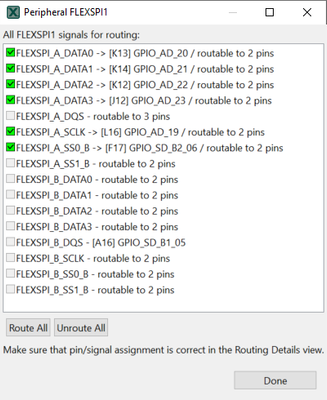

I'm trying to use UART to communicate with the RT1176 MCU, using USB by using the LPUART pins below in the picture.
Can I use USB 2.0 to UART MCP2200 chip for this task? Also is this chip supported from your software side? if not what you recommend please?
Regarding the boot I'm trying to boot only using QSPI flash W25Q128JW.

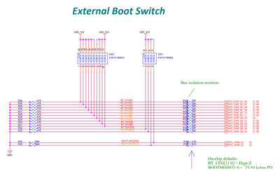

there is a reference design RT1176-EVK and the schematic can be downloaded. This might help.

In the reference manual shows many options to boots from. For my design I want to boot only from QSPI, and as you can see from the attached picture below, it shows many resistors needs to be used and Im trying to make my circuit smaller. So Im trying to avoid this method and boot using QSPI only using UART. Please advice.
