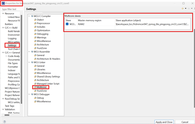

Based on the situation you mentioned, I conducted the following tests. I used the following pair of examples.
The link relationship between core0 and core1 can be seen in the properties of rpmsg_lite_pingpong_cm33_core0.
Then, as you suggested, I commented out the relevant code for notification and waiting in main_remote.c of rpmsg_lite_pingpong_cm33_core1.

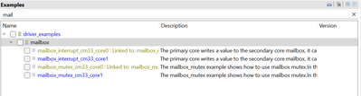

You can also use mailbox to achieve multi-core communication. There are demo like this in the SDK. You can go and have a look.

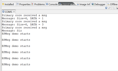

yzs
hi, @Celeste_Liu
 Thanks. I confirmed that my modification communicates properly, but I didn't comment out this code rpmsg_lite_wait_for_link_up(my_rpmsg, RL_BLOCK) and I commented out both the master side as well as the remote side (void)MCMGR_TriggerEvent(kMCMGR_ RemoteApplicationEvent, APP_RPMSG_READY_EVENT_DATA) on both the master and remote side. It may be the difference here that is causing our test results to be different, as can be seen in the attached image.
But I found that after commenting out rpmsg_lite_wait_for_link_up(my_rpmsg, RL_BLOCK) it still communicates fine!
So I would like to make sure, how to ensure that core0 and core1 are  and communicating if there is no such notification mechanism in our platform and core0 runs master_main() first?
