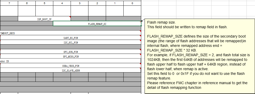

Hello NXP-Community,
I am currently experimenting with the REMAP functionality of the MCXA Family (MCXA156) as it is seems to be an ideal method swapping 2 flash spaces when doing FW updating in field.
I am facing a problem now that I am not able to REMAP half of the available 1MB Flash of MCXA156 chip.
According to the CMPA description in the reference manual attachments the tooltip hints that FLASH_REMAP_SZ represents 32KB increments for remapping range (see attached Screenshot:Screenshot 2026-03-23 175449.png

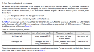

In contrast the REMAP registers of FMC0 state an increment of 8KB (Chapter 7 Flash Memory Controller (FMC)):
When LIM = LIMDP = 0, FMC disables the remap function. When LIM = LIMDP = a nonzero value, the remapping address range is (LIM + 1) × 8 KB. For example:
When LIM = LIMDP = 1, the range is ≤ 16 KB.
When LIM = LIMDP = 2, the range is ≤ 32 KB.
The value of FLASH_REMAP_SZ is copied into LIM and LIMDP field of the REMAP register. (by ROM Bootloader?) Unfortunatelly the maximum value that can be set according to CMPA description is 0x1E. With this value I confirmed that 30 * 8KB range is mapped from lower half to upper half flash.
For further context: I am able to map the desired 512KB by directly writing 0x3F into LIM and LIMDP fields within my experimental SW. I am unsure whether this is a clean way of doing flash remapping or is there a better way executing it?

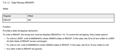

Based on the information from sections 20.5.4, 7.3.6, and 7.6.1.2 of the user manual, the following conclusions can be made:
1. The actual flash remapping range is determined by the FMC.REMAP register (LIM/LIMDP) with an 8 KB granularity.
The REMAP register defines remap_address[19:13], meaning the remap size is (LIM + 1) × 8 KB.
For a 1 MB flash device, the lower half is 512 KB, so the maximum valid LIM value is 0x3F, allowing a full 512 KB swap.
2. The CMPA field FLASH_REMAP_SZ is only a boot-time default value loaded by the ROM Bootloader.
Its maximum allowable value is a limitation of the CMPA structure/ROM—not a hardware limitation.
3. Configuring FMC.REMAP at runtime is an officially supported mechanism.
The REMAP register uses a key-write scheme (A5A5/5A5A), and writes are allowed unless REMAPLK is set.
This clearly indicates that user software is allowed to update LIM/LIMDP to any value permitted by hardware.
