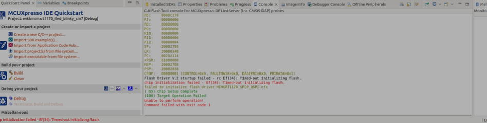

Hi, all:
I am trying a demo from the official website of Qt for MCUs. After successfully compiling an ELF and flashing it, the board can no longer be connected.
Here is the output log:
MCUXpresso IDE RedlinkMulti Driver v11.9 (Dec 11 2023 18:02:10 - crt_emu_cm_redlink build 2)
Found chip XML file in E:/4_workplace_test/14_testqt/evkmimxrt1170_iled_blinky_cm7/Debug\MIMXRT1176xxxxx.xml
(  5) Remote configuration complete
Reconnected to existing LinkServer process.
============= SCRIPT: RT1170_connect_M7_wake_M4.scp =============
RT1170 Connect M7 and Wake M4 Script
DpID = 6BA02477
Error: Wire Ack Fault - target connected?
Setting M4 spin code
Setting M4 clock
Resetting M4 core
View cores on the DAP AP
DpID = 6BA02477
============= END SCRIPT ========================================
Probe Firmware: CMSIS-DAP (ARM)
Serial Number:  024400002faba2a000000000000000000000000097969905
VID:PID:  0D28:0204
USB Path: \\?\hid#vid_0d28&pid_0204&mi_03#8&1c056edf&0&0000#{4d1e55b2-f16f-11cf-88cb-001111000030}
Using memory from core 0 after searching for a good core
connection failed - Nn(05). Wire ACK Fault in DAP access.. Retrying
Failed on connect: Nn(05). Wire ACK Fault in DAP access
Connected&Reset. Was: NotConnected. DpID: 6BA02477. CpuID: 00000000. Info: <None>
Last stub error 0: OK
Last sticky error: 0x0 AIndex: 0
Debug bus selected: MemAp 0
DAP Speed test unexecuted or failed
Debug protocol: SWD. RTCK: Disabled. Vector catch: Disabled.
error closing down debug session - Nn(05). Wire ACK Fault in DAP access
I tried change to serial boot loader, but it still not work.
The attachment contains the ELF file that I compiled.
What do I need to do to recover the MIMXRT1170-EVKB ?
Thank you!

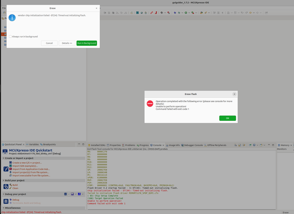

amira
@Habib_MS
I got the same issue and when I apply the two proposed solutions I get the following errors:
Screenshot from 2024-05-21 09-56-16.pngScreenshot from 2024-05-21 10-07-05.png
3,350件の閲覧回数
Habib_MS
Hello @amira ,
In order to provide you a better support, can you open a new post?
In this post you can provide me your specific problem in detail, without any problem you can tag me and with pleasure I will answer you.
BR,
Habib
