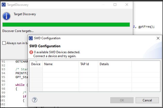

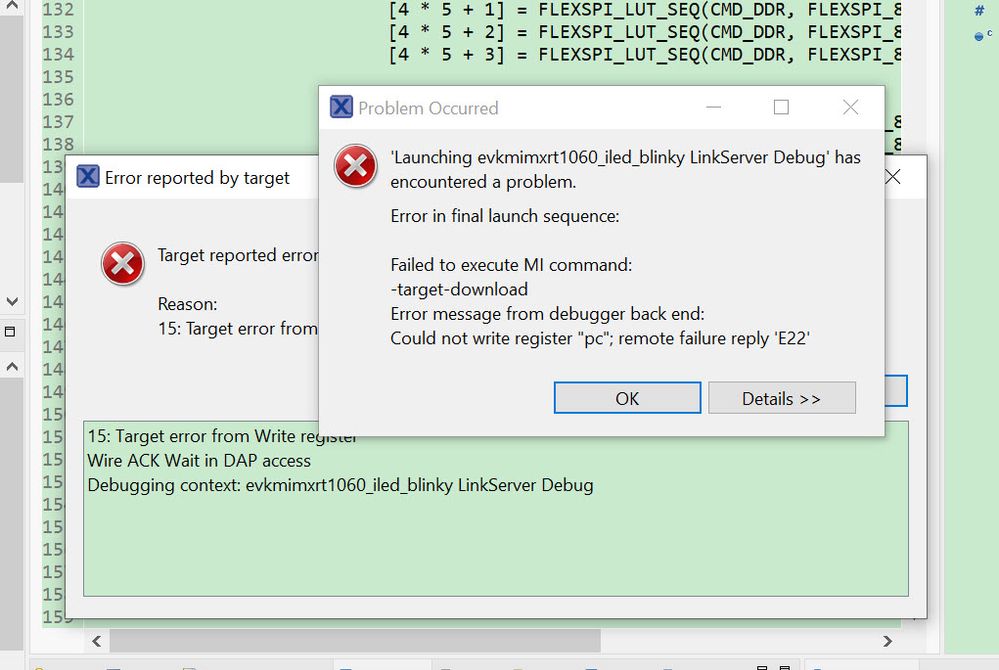

    When the customer uses the NXP RT board to debug the code, sometimes, the board   suddenly meets debug connect issues when using the IDE and the debugger to download the code. Especially to the customer who is using the NXP RT EVK board with the onboard default CMSIS-DAP debugger. They even suspect the board is broken after trying a lot of times.
    The debugger connects issues that normally happen when using the wrong FDCB, the download process is ended abnormally, the wrong flash loader, or the abnormal app code in the flash, .etc.
    The reported issue result will be similar to the following pictures:
Fig.1
Fig.2
    The connect log maybe:
      No connection to chip’s debug port
      Error: Wire Ack Wait Fault

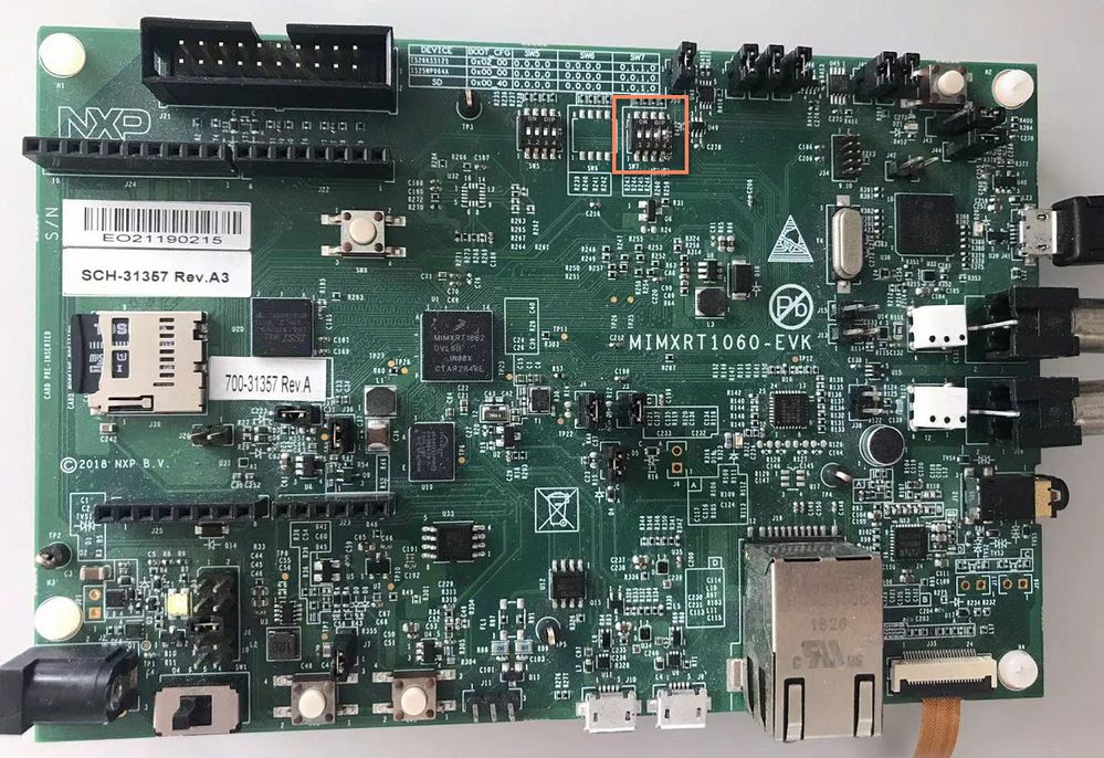

    First, let the board enter the serial download mode:
Fig.3
    Enter serial download mode:
    1) SW7: 1-OFF,2-OFF,3-OFF,4-ON
    2) Power off and power on again, or Press Reset button

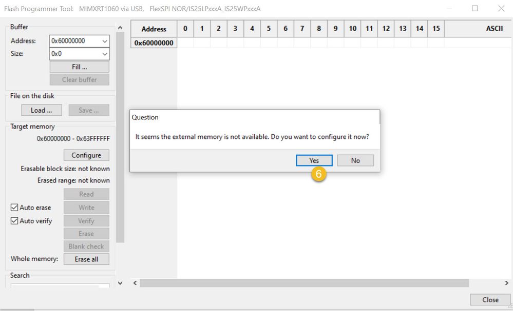

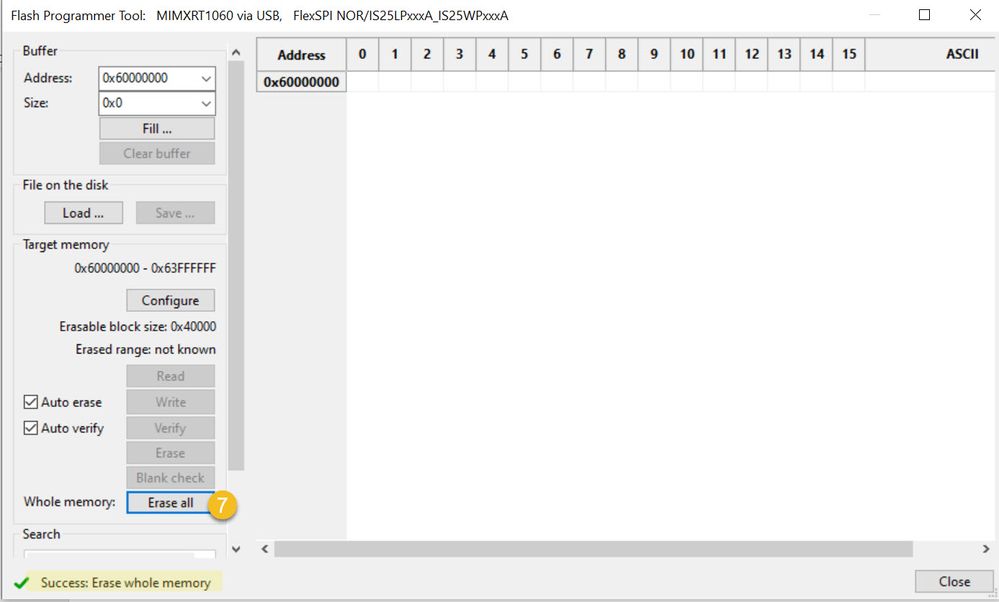

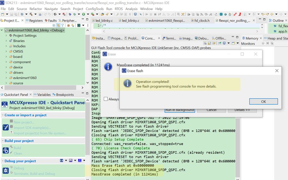

2.1 IDE Mass Erase
    MCUXpresso IDE, choose the related debugger interface, then choose “erase flash action”.
    Here take the MIMXRT1060-EVK on board default debugger CMSIS DAP as an example:
Fig.4
Fig.5
   After this operation, when the Board is back to the internal boot again, the debugger can download to the flash again.

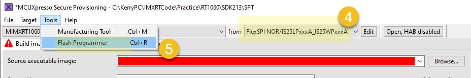

2.2 SPT Mass Erase
    Customers also can use the NXP MCUXpresso Secure Provisioning Tool to do the code download or the mass erase in the serial download mode, this method also can recover the board, in fact, just let the core in the known status.
    SPT tool download link:
https://www.nxp.com/design/software/development-software/mcuxpresso-secure-provisioning-tool:MCUXPRE...
    After installing the SPT tool, open it.

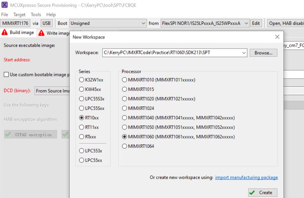

    1) Create one RT1060 workspace
Fig.6

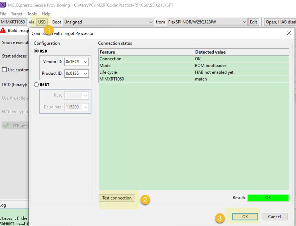

    2) Connect the board with USB or the UART
    Here, take USB interface as an example.
Fig.7

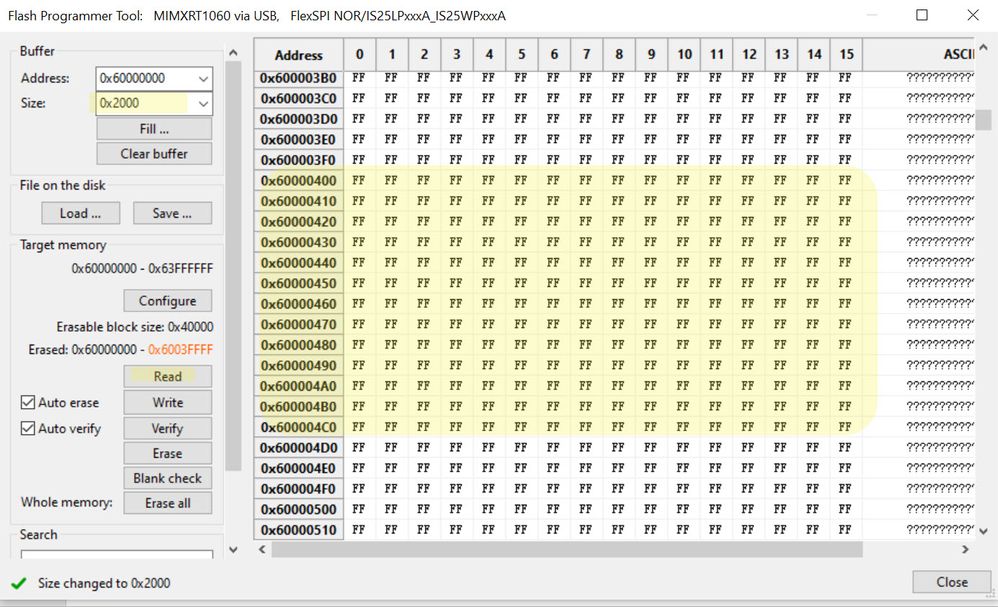

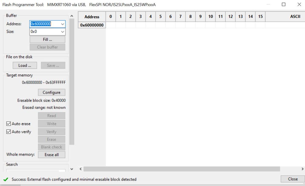

      Until now, the external flash is erased!
    In the SPT, the customer also can double check the memory, especially whether the FDCB area is erased or not, just like in the following picture:
Fig.12

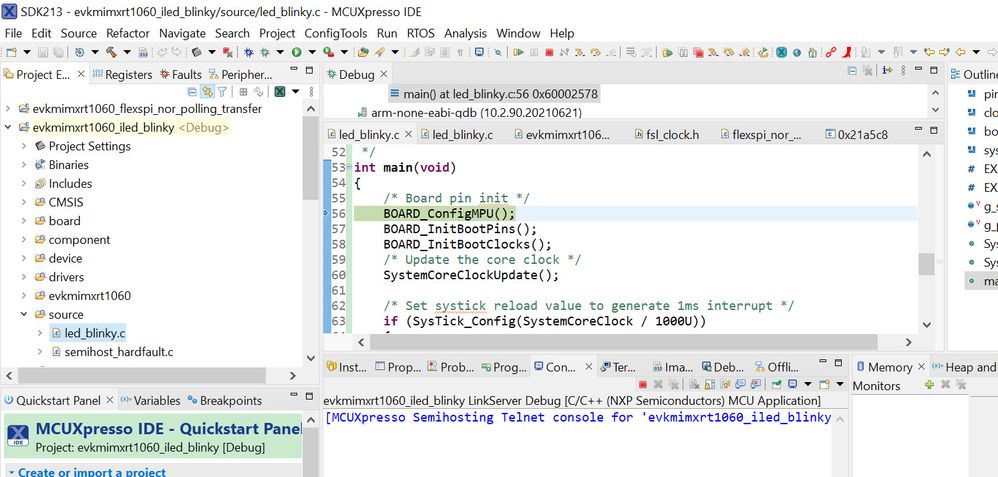

    The customer can go back to the internal boot mode and use the debugger to download the code again.
      Internal boot mode:
          SW7:1-OFF,2-OFF,3-ON,4-OFF
     Press reset or power off and power on again to enter the internal boot mode, then use the debugger to test it again, this is the result:
Fig.13
    We can see, the MIMXRT1060-EVK debugger interface is recovered!
