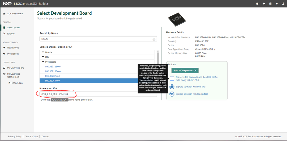

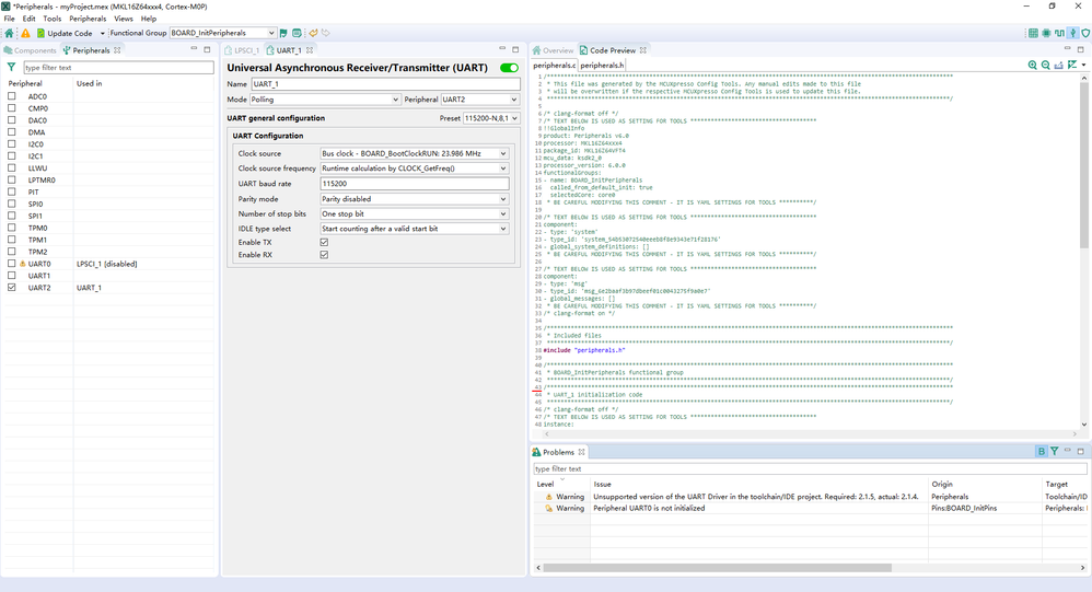

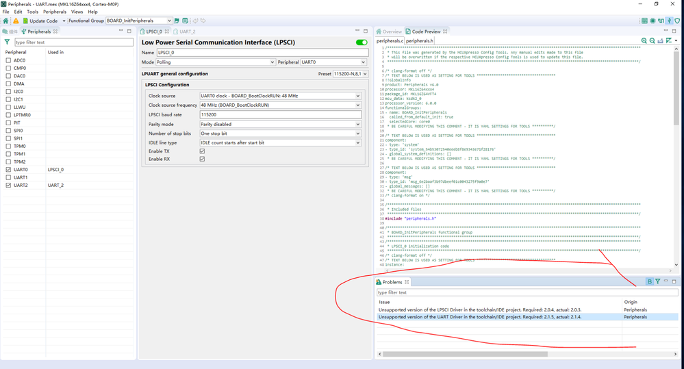

But I use MCUXpresso Config Tools v6 to configure UART0 and UART2,it says :
Level: Warning
Type: Validation
Tool: Toolchain/IDE project
Issue: Unsupported version of the LPSCI Driver in the toolchain/IDE project. Required: 2.0.4, actual: 2.0.3.
Origin: Peripherals
Target: Toolchain/IDE project: core0
Resource: platform.drivers.lpsci
Level: Warning
Type: Validation
Issue: Unsupported version of the UART Driver in the toolchain/IDE project. Required: 2.1.5, actual: 2.1.4.
Origin: Peripherals
Resource: platform.drivers.uart

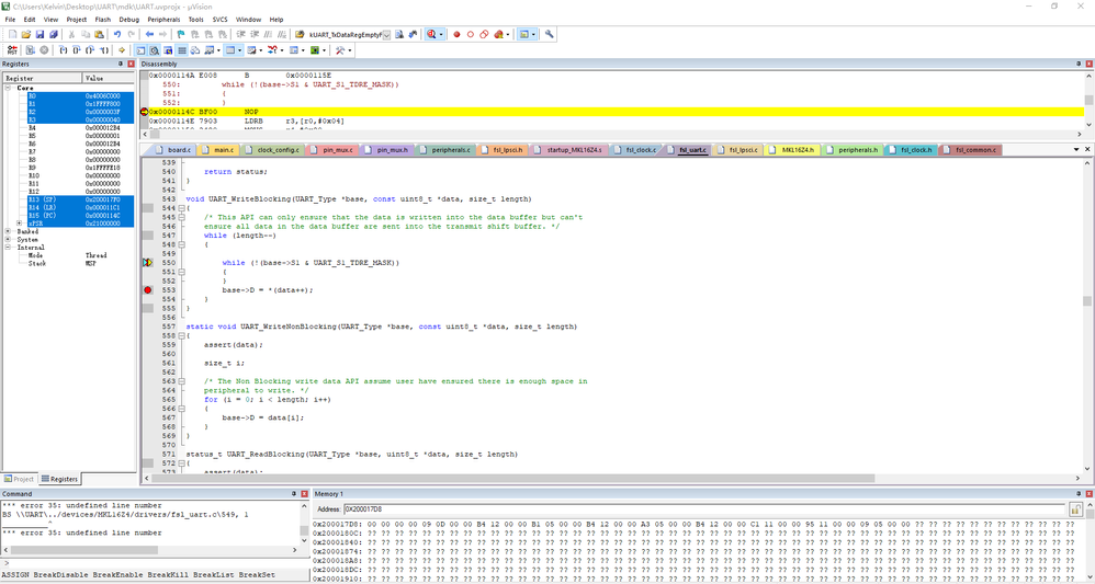

 I run the code anyway.  if it runs    base->D = *(data++);   it will be a hard fault
I don't know how to slove this problem.Can you help me?

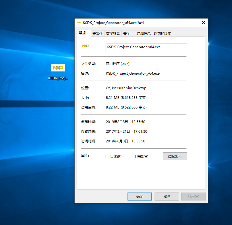

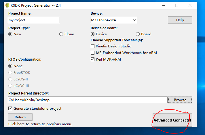

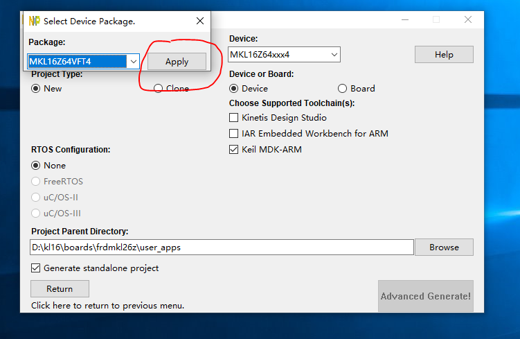

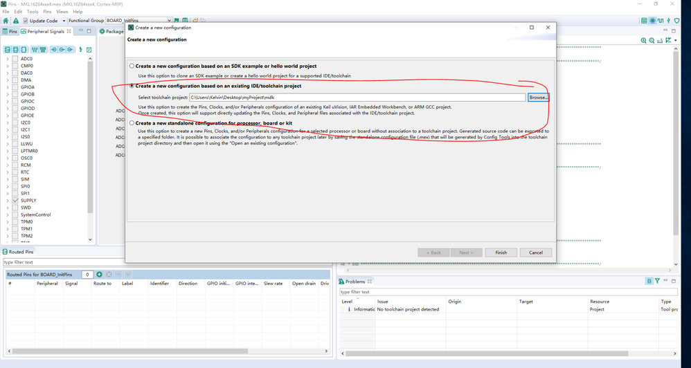

I use KSDK_Project_Genetator to creat my project.
That is how I creat my project.

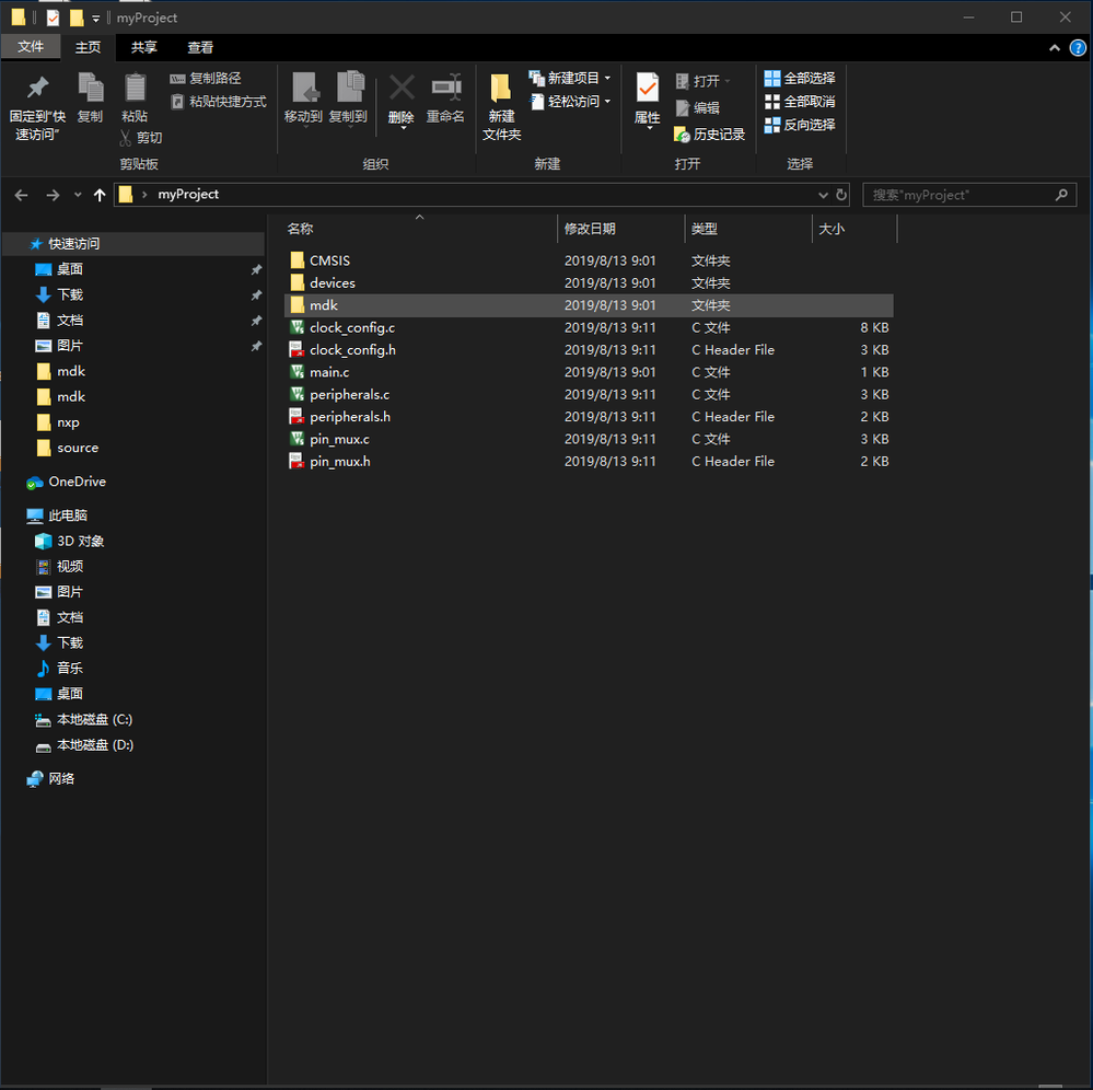

This is the project folder.

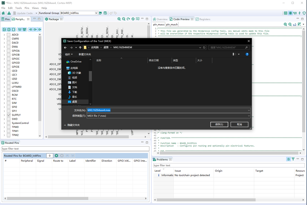

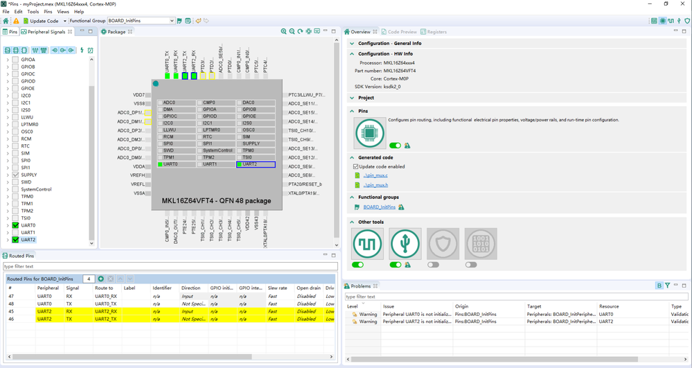

Then I use MCUXpresso Config Tools V6,
I save the configuration on my desktop/Mkl16z6MEM folder

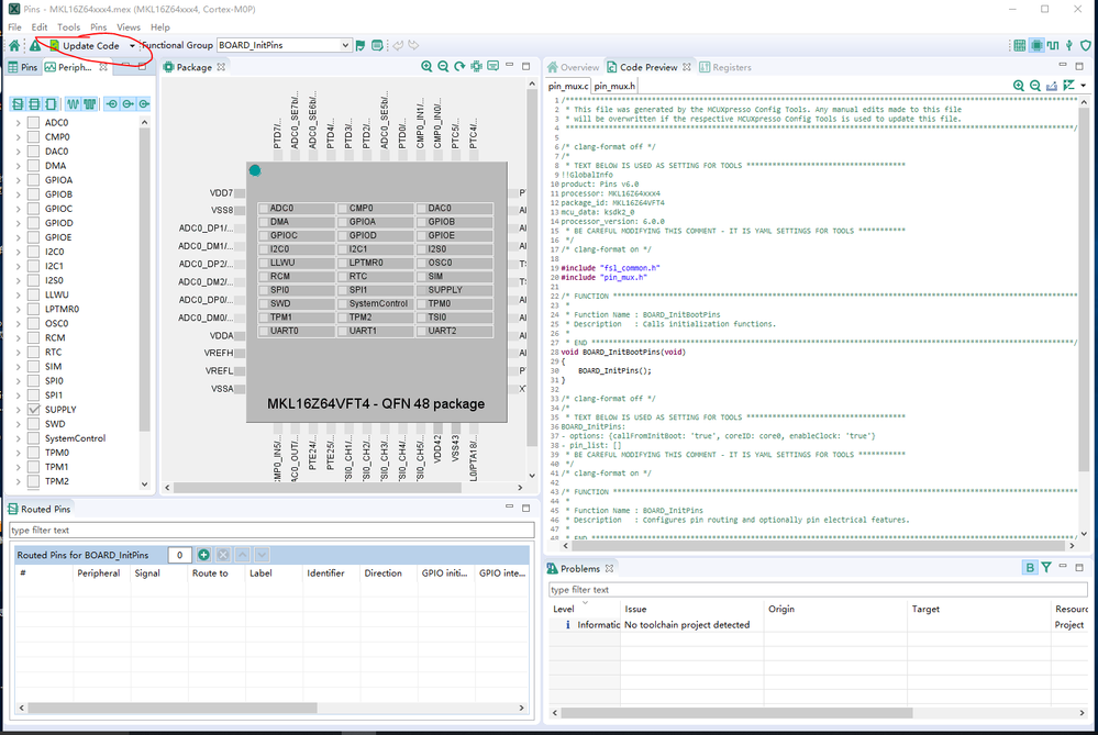

I update code
Then I get these documents

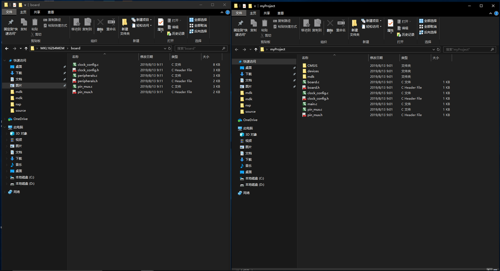

I have two folders.Left is from MCUXpresso Config Tools V6.Right is from KSDN Project generator.
I copy left folder documets and paste to the right folder to replace them.Then I delete board.c and board.h.

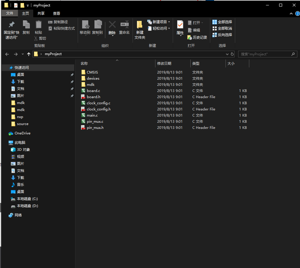

I get this now.

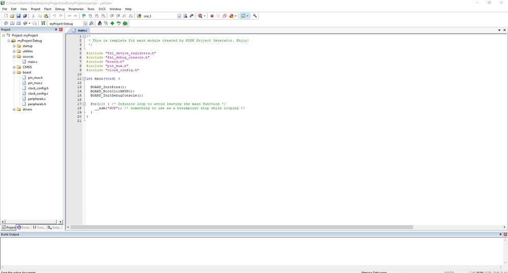

I open the project ,
add peripherals.c and peripherals.h ,remove board.c and board.h
rebuid the project.I get the project now.

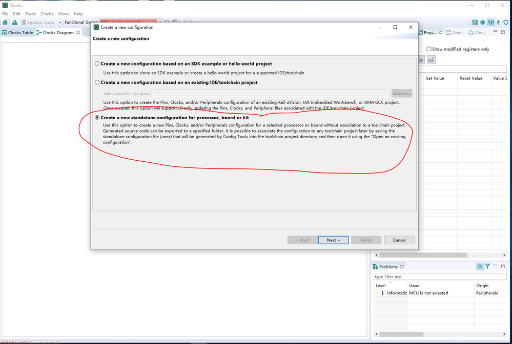

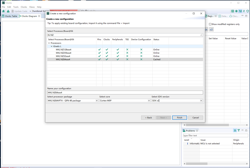

I opean Config Tools again,and choose second one.
That is how I get this warning
1,802 次查看
jingpan
I followed your guide step by step. Yes, it is true. I don't know why. I guess there maybe some version control problem.
I think you can ignore this problem. Is the hardfault problem still there?
