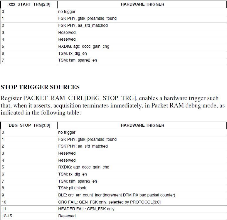

Hello.
Can anyone give me some details above start and stop triggers?
I'm not sure what triggers are used for each situation.
