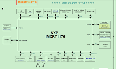

Even the dead-simple iled_blinky demo app built with the EVK SDK won't load and run on an EVKB.  Why?
And most importantly, how can I re-target apps build with the EVK SDK to the EVKB SDK.
Thanks very much.

kerryzhou
Hi @Littell ,
  Thank you for your interest in the NXP MIMXRT product, I would like to provide service for you.
1. please use the following link to do the mass erase at first:
https://community.nxp.com/t5/i-MX-RT-Knowledge-Base/RT-board-recovery-for-debugger-connect-issues/ta...
2. To the MIMXRT1170-EVKB, please download the EVKB related SDK, and import the code from the EVKB SDK:
https://mcuxpresso.nxp.com/en/builder?hw=MIMXRT1170-EVKB
3. About the EVK and EVKB, the used QSPI flash is different, so the XIP FCB have difference.
This is the EVK flexspi_nor_config.c
#define FLASH_DUMMY_CYCLES 0x09
#define FLASH_DUMMY_VALUE  0x09
const flexspi_nor_config_t qspiflash_config = {
    .memConfig =
            .tag              = FLEXSPI_CFG_BLK_TAG,
            .version          = FLEXSPI_CFG_BLK_VERSION,
            .readSampleClksrc=kFlexSPIReadSampleClk_LoopbackFromDqsPad,
            .csHoldTime       = 3u,
            .csSetupTime      = 3u,

This is the EVKB flexspi_nor_config.c
#define FLASH_DUMMY_CYCLES 0x08
#define FLASH_DUMMY_VALUE  0x03
    .memConfig =

You can see, the LUT, the dummy cycle have difference.
So, if you want to use the EVK demo to download to the EVKB, you need to modify the flexspi_nor_config.c code to the EVKB code.
In fact, I suggest you use the EVKB SDK directly, that will be more easy to you.
Wish it helps you!
