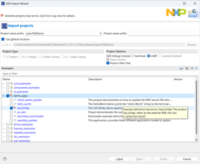

Hello!
I`m using MCUXpresso IDE v11.9.1 [Build 2170] [2024-04-19]. After  PN7642 MCUXpresso SDK v02.15.00 installation I`m trying to import example from SDK but I cannot complete example import because of error that is shown after example selection
There was no such problem with previous SDK version. What can be the reason and how to fix it?
Thanks in advance.
Artem

Hello @ArtemPN,
Hope you are doing well.
Please, unzip the SDK package by right clicking the file in the Installed SDKs window > Unzip archive:
After this, try importing a project from the SDK. Please, let me know your findings.

ArtemPN
Thank you! Now all is OK.
