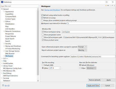

ZhangJennie
This is config tool setting.
This is workspace setting
You can try to "Restore defaults" if you have problem.
On my side, I can't reproduce your issue.If you can find out how to reproduce it, please let me know. I will check.

scottm
Senior Contributor II
Hi Jun,
I meant in what file(s) are the settings stored, so I can check how they're actually saved?
I tried resetting to defaults and the problem persists. I can create a new workspace, but it seems like every few weeks some problem turns up that requires creating a new workspace. It's tedious and disruptive. I'd rather figure out how to fix the configuration problems.
