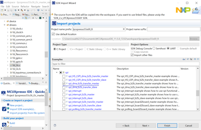

The SPI supports DMA mode, you can use DMA to transfer data from memory to the SPI data register. We have the DMA plus SPI example in SDK package.

The SPI driver is inefficient, if you want to get the spi fastest transfer, I suggest you use polling mode and directly write the spi FIFOWR register, poll the status register and check if the transfer is over....
