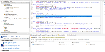

Goodday,
I've imported the JN-AN-1244 into MCUXpress. I've set the MCU to JN5189 and the associated SDK is JN5189DK6 version 2.6.13.

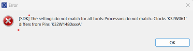

When I go to the "Pins" configtool and select the JN-AN-1244 project I get the message:
Can I solve this?

Ricardo_Zamora
Hope you are doing well. When using Connectivity applications, it is recommended to use the Connectivity Framework. Such as the "Keyboard" and "GPIO Adapter" services. So, could you please try to taking as a base these services? (Please refer to SDK\docs\wireless\Common\Connectivity Framework Reference Manual.pdf)
