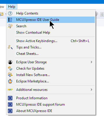

BlackNight
and search then for 'GUI Flash Tool'.

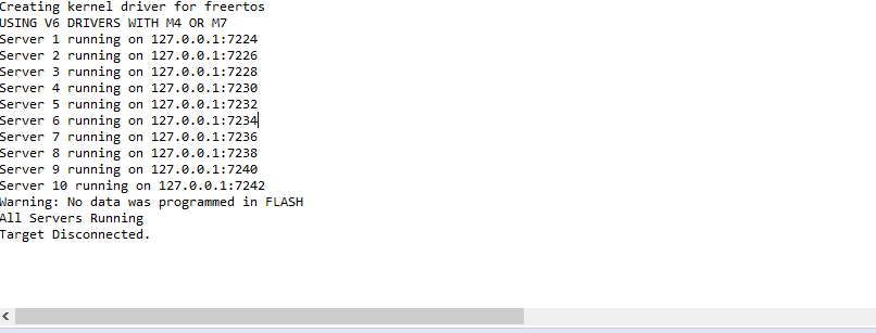

kaarthick
Hai Erich,
After installing MCUXpresso 11 , I am getting the same error. Refer image below
