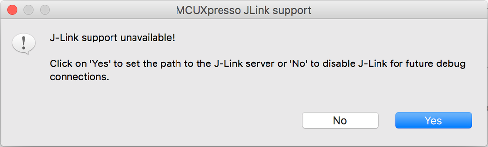

I'm making the transition from KDS-2.x to MCUXpresso 10.1.1 and have run into a small snag.
Short form:
When I try to debug my device, I get an alert:
... and I'm not sure what it wants in the way of a path to the J-Link server.

What Happened:
When it first prompted me for a path to the J-Link Server, I clicked on "No", whereupon it failed with the message "Error in final launch sequence: Cannot get Jtag device".
The next time it prompted me, I clicked "Yes" and supplied "/Applications/SEGGER/JLink_V630i/JLinkGDBServer.app" as the path.  Evidently it didn't like that either, since it immediately repeated the same dialog box.
So this time I provided "/Applications/SEGGER/JLink_V630i/JLinkGDBServerCLExe" as the path.  This caused the dialog box to disappear, but the build still failed with "Error in final launch sequence: Cannot get Jtag device".

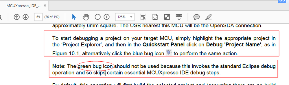

Hello Robert,
Yes, the green icon can't used on MCUXPresso , please use the blue icon(or the one under Quickstart Panel):
You can find this information in "MCUXpresso_IDE_User_Guide.pdf":
Hope it helps
TIC

lpcxpresso_supp
Yes, we always recommend using one the MCUXpresso IDE debug buttons, generally the one on the Quickstart Panel (rather than the generic, green, Eclipse one). This way the IDE can then automatically discover the debug probe connected to your PC and generate an appropriate debug launch configuration.
Again, for more details please see the MCUXpresso IDE v10.1 User Guide. Or for a quick overview, watch the video at  Video Link : 7772
MCUXpresso IDE Support

lpcxpresso_supp
The issue here is that SEGGER have recently changed the way they deliver the executables in their firmware package on Mac (and Linux) such that the IDE's autodetection of the SEGGER executable no longer functions correctly. If you are using the version of SEGGER delivered with the IDE, then you won't have problems. But if you manually install a recent (v6.3x) version then you will encounter the problem you have seen.
This issue will be resolved in the next IDE release. But you can actually easily fix the problem by manually selecting the JLinkGDBServerCLExe file from within the SEGGER software installation you have installed yourself, via
  • Preferences - MCUXpresso IDE - J Link Options
For more details, please see section 3.8.1, "SEGGER Software Installation" of the MCUXpresso IDE v10.1 User Guide.
PS : As you are using Mac OS High Sierra, I would suggest that you also take a look at this post and potentially install the user supplied patch....

robertpoor
Senior Contributor I
As you indicate, the user must select JLinkGDBServerCLExe for the path to the path to the J-Link server.
That is necessary but not sufficient.
The user must also use the blue debug icon and not the green debug icon for things to work.  Not intuitive, but it works!
3,423 Views
robertpoor
Update: I got it to work (but I don't know why it worked)...
I quit MCUExpresso, deleted the project directory (and .metadata) and re-created the hello_world demo from scratch.
This time, instead of clicking on Run => Debug Configurations and adding a new configuration under GDB Segger Interface Debugging, I clicked on the Quickstart Panel's "Debug 'frdmkl27z_demo_apps_hello_world' [Debug]" line.
This time, it put up a modal panel saying that it was discovering SEGGER J-Link probes and also asked for a path to the J-Link Server.  And as before, I gave it a path to JLinkGDBServerCLExe.
This time, it put up a new "Probes Discovered" panel, with the J-Link listed as Available.  I selected it and clicked "OK".
This time it compiled and entered the debugger without any errors.
Lessons learned:
The only lesson I can draw from this experience is "Use the Quickstart Panel to launch your app."
But I'd still like to know what was wrong with the first approach.
