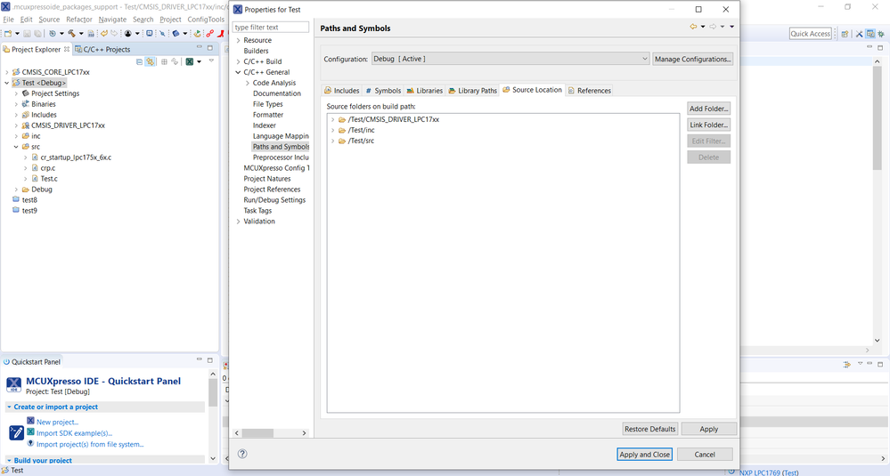

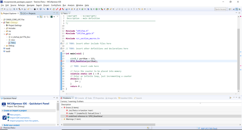

Hi. I want to  add include file from outside of my project. If ı add my inc folder to includes, builder give unreferance error. I cant add this folder to my project folder and ı cant create static library. How can ı add this folder to my project in MCUxpresso?
SOLVED:
WE MUST TO ADD SOURCE AND INCLUDE FILE TO "SOURCE LOCATION"

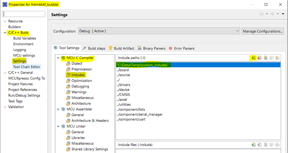

Adding another folder with header files to the search path is really straight forward. Please take a look at the following screenshot.

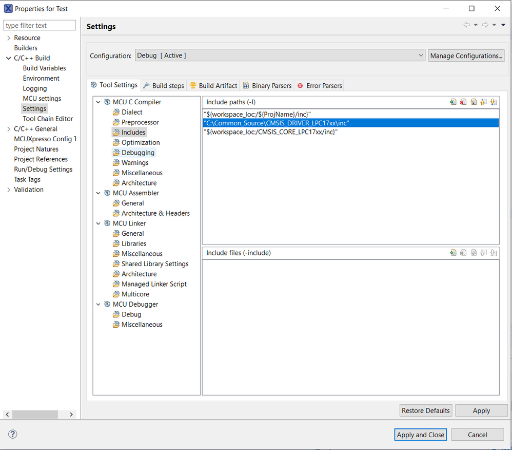

My settings is like this already. I think i need more setting. What do you think i'm missing ?
