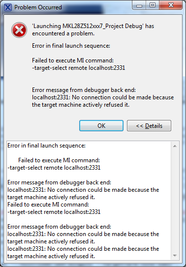

I have the same problem "Failed to execute MI command", using MCUXpressoIDE_11.0.0_2516.exe with
    JLink_Windows_V647d.exe or
    JLink_Windows_V646h.exe or
    JLink_Windows_V646g.exe
Target is FRDM-KLM28Z SDA
The same thing happens using the Segger Jlink probe and the 10 pin debug connector.
The blinky program runs, the LED is flashing, but the debugger is having problems after the erase. flash, verify cycle.

nathan4
Have you tried deleting all existing debug configurations then creating a new one from scratch using the blue debug button?
It seems the blue debug button places some additional critical configuration setting in the launch file if created from scratch.  The green debug button "Debug Configuration" does not do this but can be used to edit a configuration (which was created via the blue button).
I *think* the critical configuration entry the blue button adds is...
<stringAttribute key="org.eclipse.cdt.launch.PROJECT_BUILD_CONFIG_ID_ATTR" value="com.crt.advproject.config.exe.debug.1497756402"/
...located in the "<project> JLink Debug.launch" file under the project folder.  Or located under the .metadata folder if you haven't launched the configuration yet.
Note, you can browse through the console's "Display Selected Console" to see the actual GDB spam to confirm your "Failed to execute MI Command" failed on the same command as mine.
