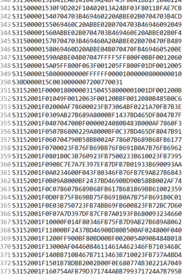

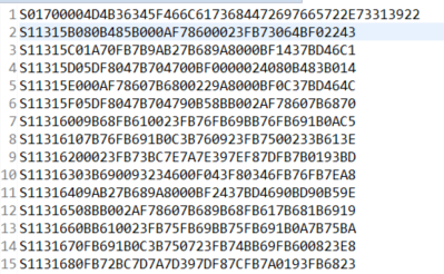

Hi,I'm working on a project that I need relocate some code into ram,and I successed,after that I want to generate a S19 file only have this segment with ram address . I changed the linker file ,the address in the S19 file is still the flash address.What I should do to generate the right S19 file only cantain the code segment with the ram address without other code.The mcu is MK64,Thank you!

I successed got a S19 file only with the ram address that I relocated.I modified the startup file,deleted some code.I found the code didn't referenced by main wouldn't be compile.How can I change the compile option in MCUXpresso.

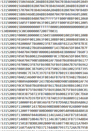

Thank you for your support. I rewrite the linker file, now I can get a S19 file with the ram address that I relocated,But,there's still flash code in the S19 file. I tried deleted the other section in the linker file ,but that would get some errors occured. I found the reason is that in the startup file defined some section.

Hello  fei Gao,
Yes, after relocate code into RAM, the code should still in FLASH, it is just executed from RAM.
Or after re-power , the code disappeared.
And S19 only includes code and data in FLASH.

Thank you for your answer,I successed generated a S19 file with ram address,but now there's still flash code in the S19 file.
